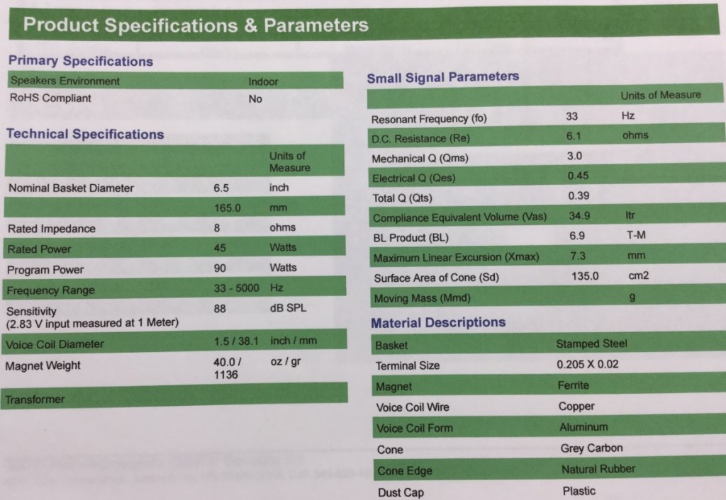

Hello Dave , this is how they are wired
Here is the driver information
Good luck Ken

This 3 driver connection are a mix of Parallel and Serie or a quasi Parallel.
The final impedance resulting should be measured.

Thank you Ken.  This is what I had thought was most likely and had posted in this thread, two in series and in parallel to the third.  But, the discussions against it were logical and compelling.
