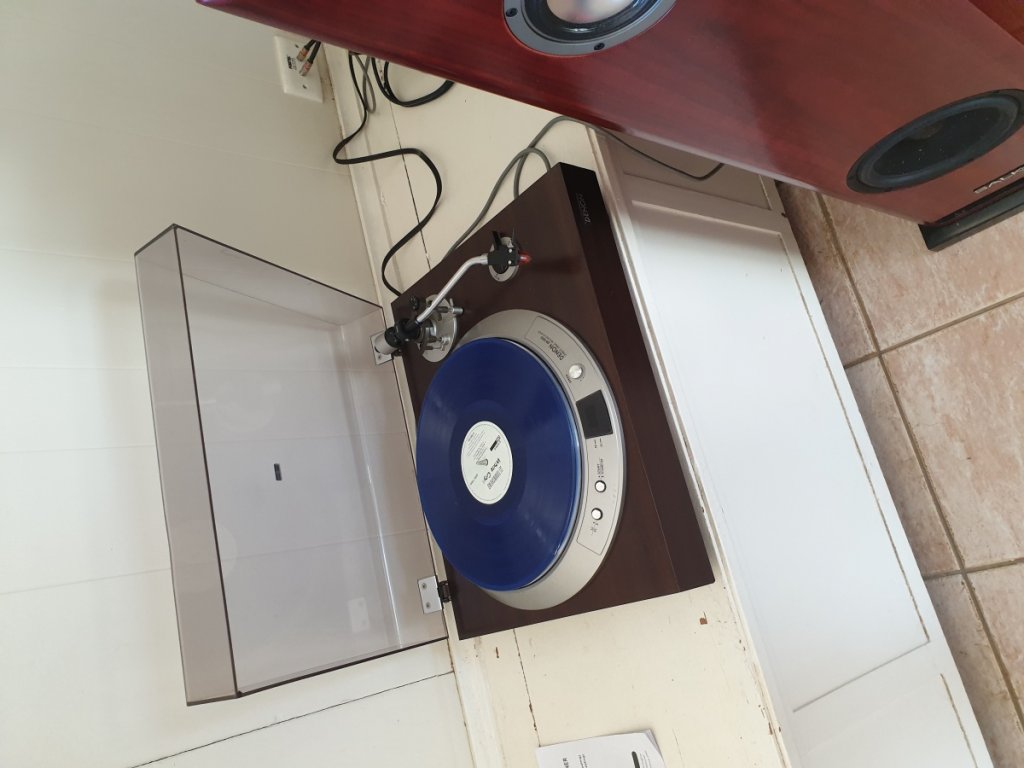

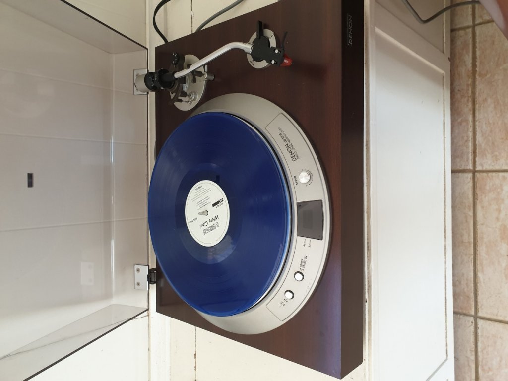

Hi Guys,
I just bought my 4th turntable :).  I purchased this as I've always wanted to try a good quality direct drive turntable and my technician has worked on this one and highly recommended it to me.  It cost me $550USD and the dealer fitted an Ortofon bronze cartridge which I had spare.
When I first installed the Denon in my system I felt a bit disappointed as I thought my belt drive Goldnote Piccolo turntable (using an ortofon 2m red) sounded better.  It sounded a bit lifeless and lacked dynamics and high end detail.  I do notice that the rear of the tonearm is a bit lower compared with the cartridge.  I'm wondering if anyone knows how to adjust the tonearm so I can adjust VTA?
I'll keep you updated on my progress.
Cheers Rod

Hi Rod,
That looks like a Jelco tonearm. Newer Jelco tonearms have a set screw in the collar holding the tonearm on the side below the anti-skating adjustment. By loosening the set screw one can adjust the hight of the tonearm. I would check if your tonearm has that.
Nice looking table!
Boris

« Reply #4 on: 9 Feb 2020, 03:36 am »
According to Vinyl Engine your table might have two set screws on the back of the collar to adjust tonearm hight.

Hi Guys,
Thanks for the information. I located the 2 screws (flat head type) at the rear of the tonearm collar.  I've raised the tonearm a bit higher and I'll see if that makes a difference.

« Reply #13 on: 10 Feb 2020, 03:31 pm »
Rod, if your pics provided are an indicator as to where and how your TT is set up / located, not good, way too close to your speaker.

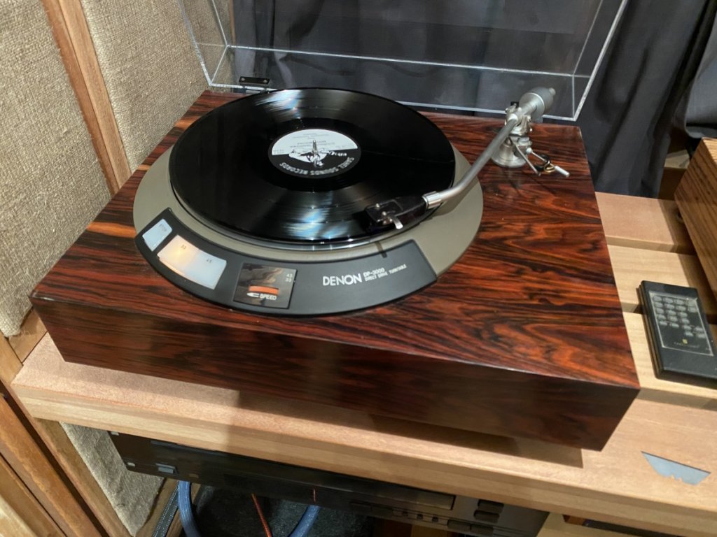

A couple years ago I built this DP-3000 with a deck I bought from a seller in Japan, an FR-54 arm I found on CL and an Ortofon 2M Blue.
The plinth is solid Baltic Birch with Brazilian Rosewood veneer.
It's a great deck

Hi Guys,
Point taken about the location of the turntable in comparison to the speaker.  Unfortunately I'm limited to where I can place the turntable.  On a positive note I took the Denon and my old Bluenote turntables to have them properly set up with my technician.  The dealer didn't really install the cartridge all that well as it was a little loose in the headshell and wasn't aligned property and vta wasn't correct.
The denon really is quite a nice turntable.  I like both of the turntables in my system but I think with the better cartridge the denon has more bass and is quieter when compared with the bluenote.
Btw great job on the new plinth for the Denon DP3000.
Cheers Rod
It's a great deck
Beautiful deck!
