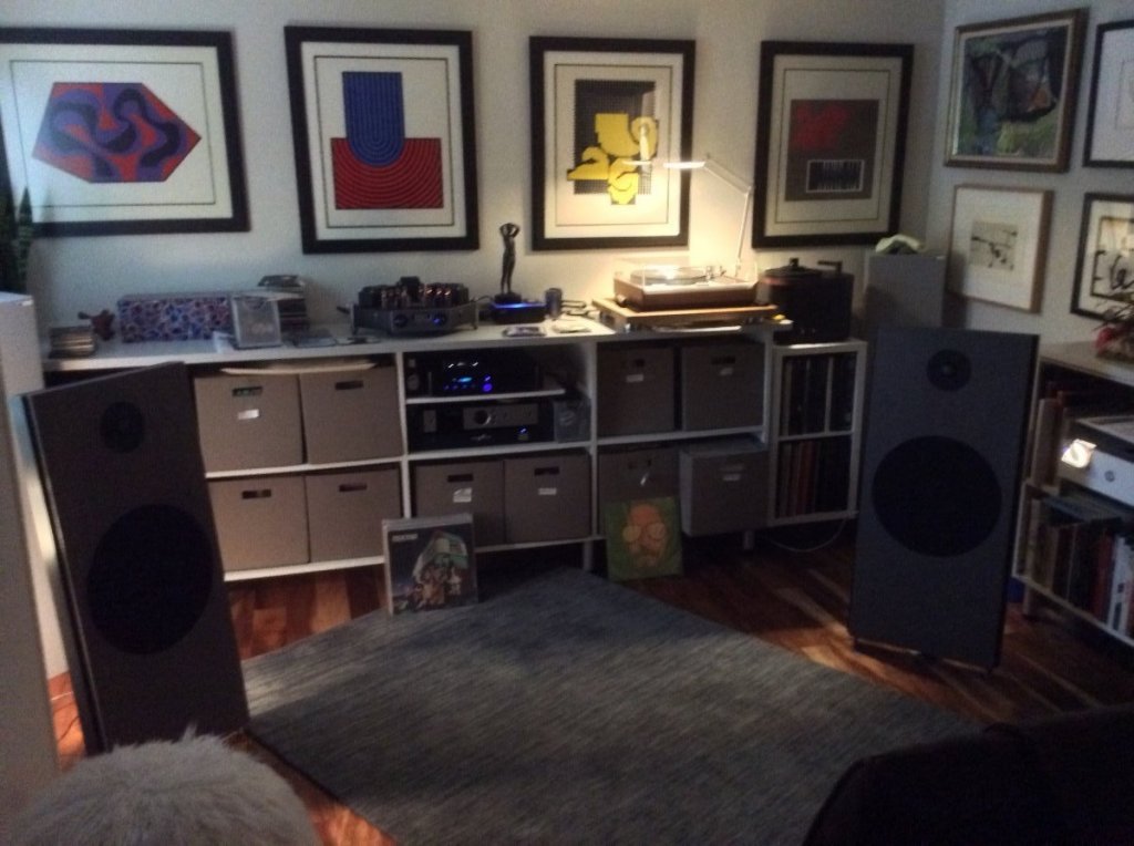

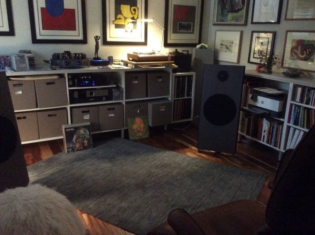

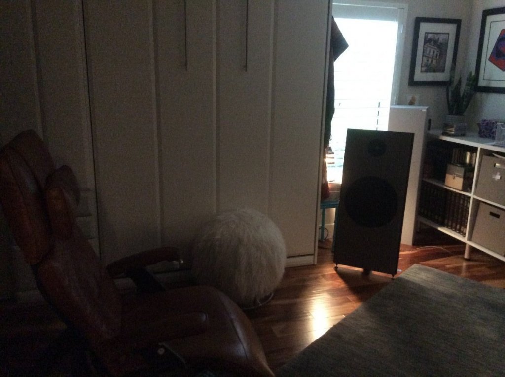

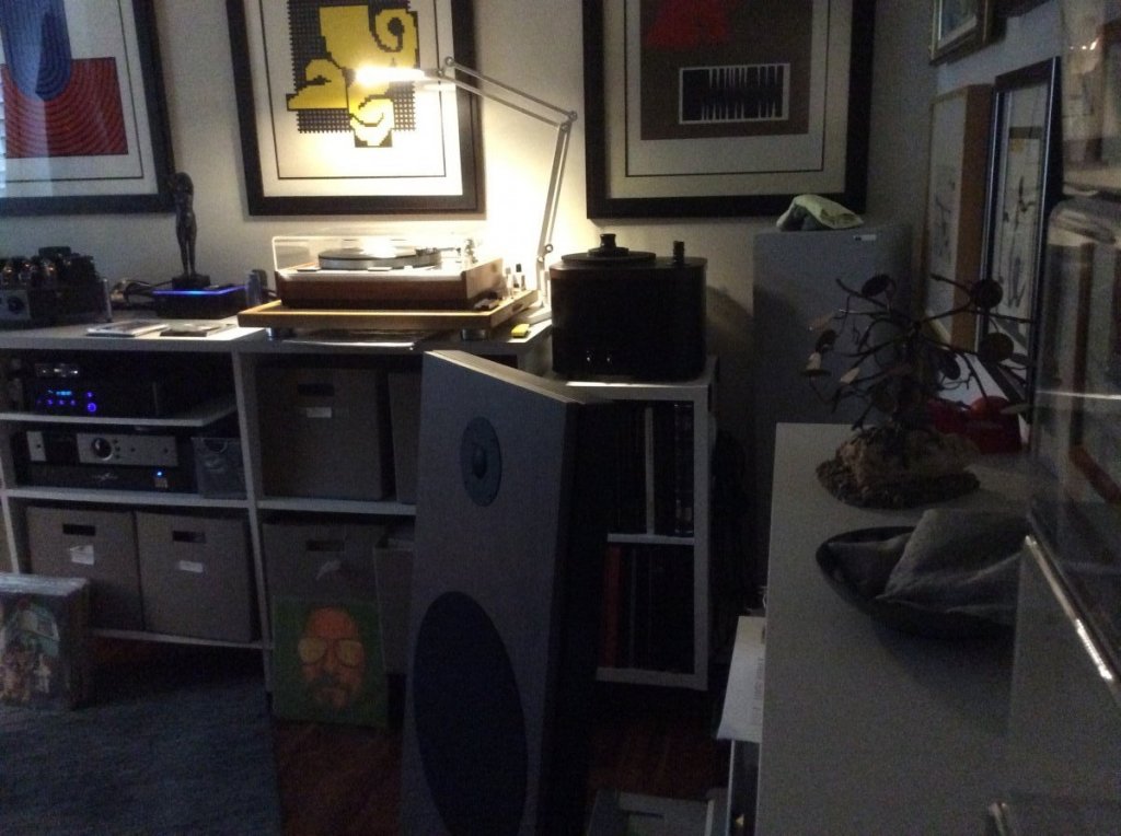

I have about 170  hours on the M fives now.  I’ve been playing with positioning of the speakers and have found I am really enjoying extreme toe in.  They are crossing about 2 to 3 feet in front of me. In this small room it seems to really work nicely . After biasing the Stingray, adding the bass  traps , getting to 170 hours and the toe in position I am loving the sound . The toe in added life to low volume listening.

That’s what  motivated me to try it , I actually like the way the speakers look a bit better with the extreme toe in. In this  Room with this amplifier the  speakers are totally disappearing,much more alive and defined. I am sticking with it, at least for now!
