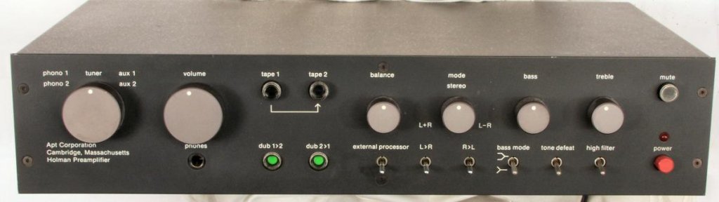

I was about to post that it sounded more to me like a L-R channel issue until I saw it was resolved. I'm glad it got worked out.
I say it sounded like a left-minus-right channel issue because the specific symptom you described reminded me of the channel selection feature I had many years ago on my old Apt Holman preamp, a feature I've never seen on any other unit. Rather than the traditional "Mode" switch or button (for stereo/mono selection), it had a knob. The center detent was standard stereo, and turning it one way or the other gradually either summed the channels (labeled on the face plate as "L+R") for full mono at one extreme, or in the other direction it gradually subtracted the content that was common to both channels (labeled "L-R"), until, turned as far as it would go, you would delete all of those sounds. That made it extremely effective in removing lead vocals (your comment about Karaoke brought this to mind), though sometimes at the expense of the bass and some drums, which tend to be mixed in the center. But it was fabulous at isolating background vocals if the singers were recorded in either the left or right channels only. It helped me decipher the lyrics of the countermelody in Jackson Browne's "From Silver Lake" among others. I kind of miss that feature (I miss the preamp, too). It was a lot of fun to play with. You can see it in the photo.
