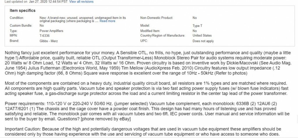

Anyone look at these.  "OTL Amplifier Stereo Pair 20 Watts w/8 Ohm Load, New Quality Parts & AssemblyIntriguing" sold by "raelectron".  He is in Arizona if I recall correctly and builds one of these every few months and puts them up for sale on Ebay.  Apparently based on a design found in a magazine.  He has a fair amount of five stars associated with the sale of these as I look back through his feedback history.  Not sure if I could get by with 20 watts; tempting though.  Has anyone listened to one?  The last one just sold for under $400 a pair.  Don't see how could make and sell them for that little.

Could we see this announcement?

Hope this does not violate forum policy.  Here are two GIF's

PS, don't know this guy; so no idea if this is legit.

Description said its based on Futterman, Tim Mellow and Dickie/Macovski what may be a unstable mix, I could not locate this ad, seems sold, as he does no accept returns better you pass this unsual amp.
