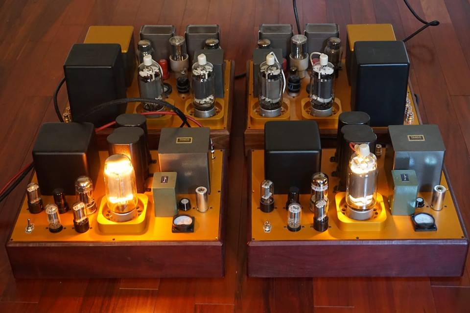

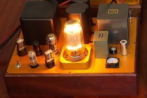

GM70 SE 15W amplifier.
At 800V on Plate the GM70 sounded quite good, and you dont have to run at 1200V ( I did make 2 GM70 amplifier running at 1200V great sound too.). The reason I build this 15W GM70 amp is because I want to try the rare  Tango Permalloy NY15-3.5S. I am not disappointed!
