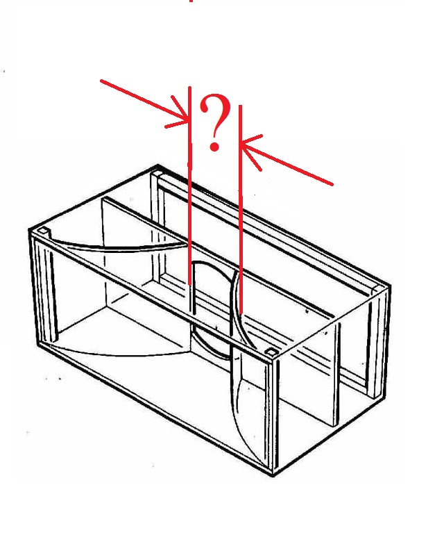

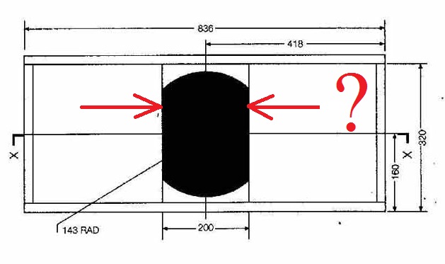

Hello everyone.

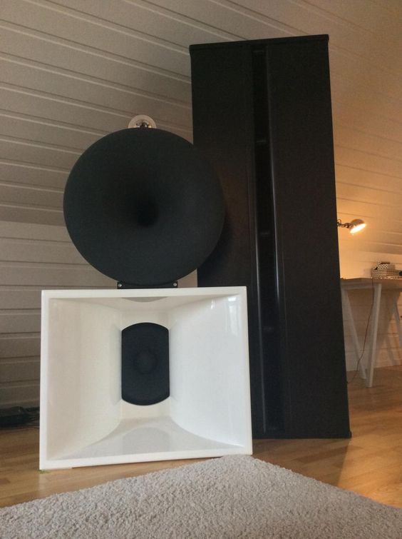

I have a question about the design of some some front loaded horn enclosures .
I often see this type of horn enclosure  ,  and what puzzles me is how the designer determines how much of the cone area is covered by the horn structure ( or baffle ) in front of it.
Is this a design function specific to the driver ( e.g. its T&S parameters ) , or  some other method.
The amount of frontal cone area covered by the horn structure does seem to vary considerably .
Can anyone here briefly explain the process to determine this seemingly varied dimension ?
Thank you  in advance  for any help with this.
Vic.

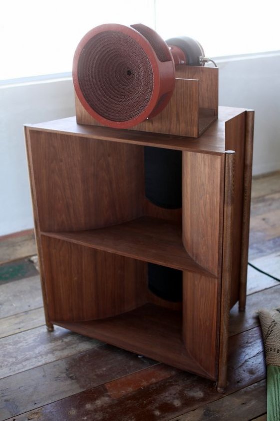

Well Iam really no expert in the subject and cant response your question without a search, but I suspect its no rocket science. However this type of horn design figured above are used in low quality plastic horns and even pro-audio horns for mid range and hi freq drivers.
IMO the horn neck dont cover the entire driver dome area, at least in the horns I have see in loco, since these horns are not circular, but limited vertically, for this these horns are also named compression horns.
A more suited horn for hi fi audio are these round horns mainly in real wood.
My 2 cents.
https://sites.google.com/site/diyfirefly/320-hz-round-tractrix-horns

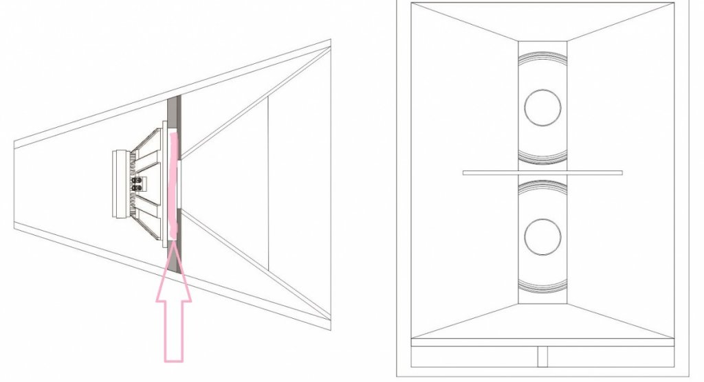

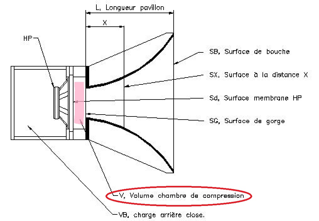

Hi FullRangeMan
About the last thing I expected to find in front of a horn , is a  " compression chamber " ..........
Like this ......
Really puzzled  by this.
Apparently often seen on higher end speakers too ?

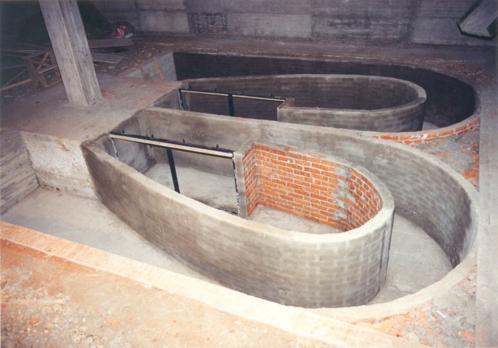

There's a ton of math behind proper horn design.  But note that to be effective as a bass horn, it must be huge and highly reinforced.  Take the Klipsch-horn as an example.  It ingeniously uses room corner (9 feet of continuous wall on both sides) to complete the horn, but the cabinet walls are not sufficiently braced in the opinion of many and yet is only rated down to 40 Hz.  A more successful design is reinforced concrete horns (the size of a garage).  Just think of the size of the sound waves involved (20 Hz = 56 feet, 50 Hz = 22.6 feet) and this starts to make sense.
