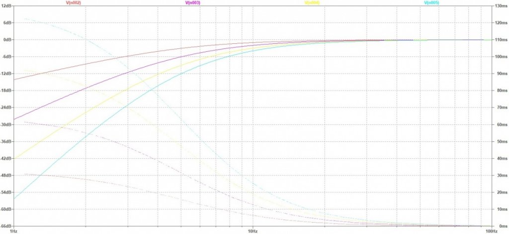

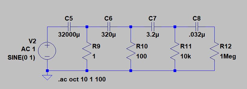

I always lean toward no preamp.  Preamps are typically not DC coupled.  This is because DC offsets are cumulative and multiplied by the gains of each stage.
Driving Cherry amps (post-2013 models) directly with a Cherry DAC DAC is just about the only way to have an end-to-end DC coupled system.  This is simply the way bass was meant to be delivered!  Zero phase shift.
Some preamps have four AC couplings between the input and output, then most amps have another one or two.  The source usually has one or two as well, so there can be as many as 8 AC couplings total.  That's a lot of cumulative phase shift, which exhibits itself as "group delay" in the end.  There's significant delay at 20Hz from only one AC coupling at 5Hz.  An AC coupling is going through a capacitor, for example.
Check out the simulation circuit (in x100 steps for loading purposes) and note response plot (right vertical axis is group delay) showing group delay approaching 10mS at 20Hz with only 4 stages of AC coupling (5Hz "cutoff")!

Looks like I need to post an inverted version of the graph. It’s pretty hard to view on my phone!

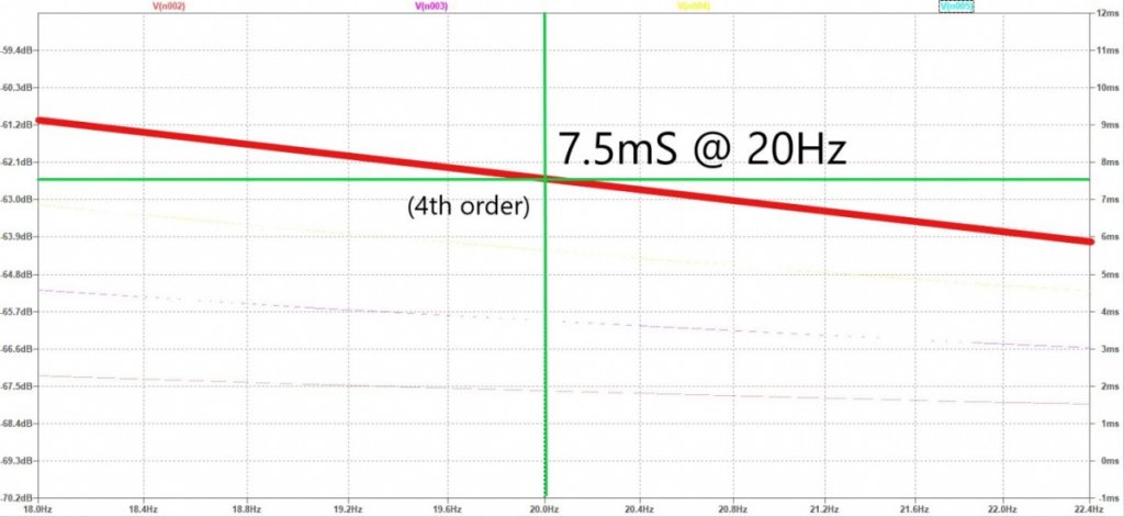

« Reply #2 on: 7 Jan 2020, 03:02 am »

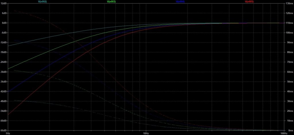

« Reply #3 on: 7 Jan 2020, 03:18 am »
Even better....

A little math....  20Hz is 1/50mS, so a 7.5mS delay is 15% of the total 20Hz waveform (54° phase shift).
