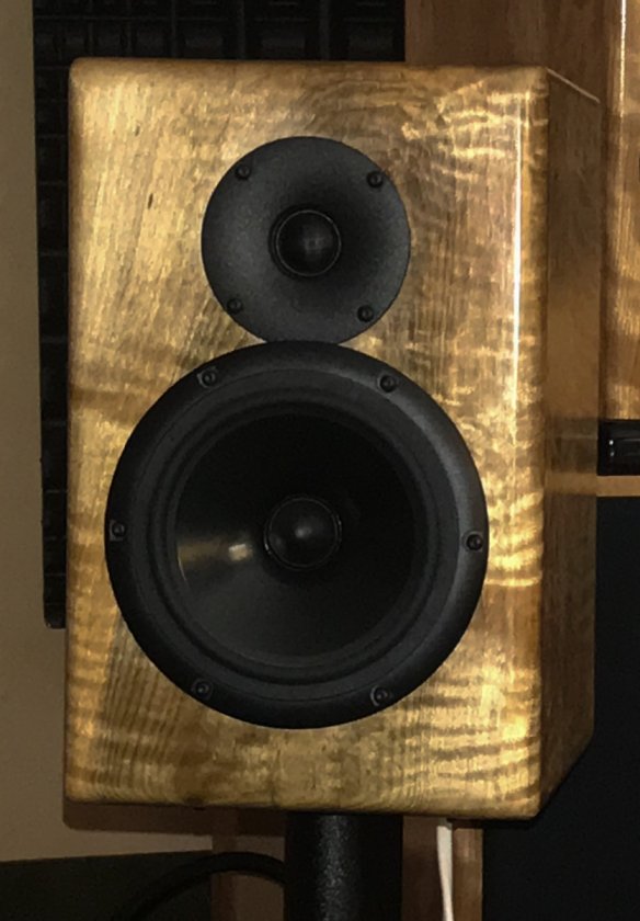

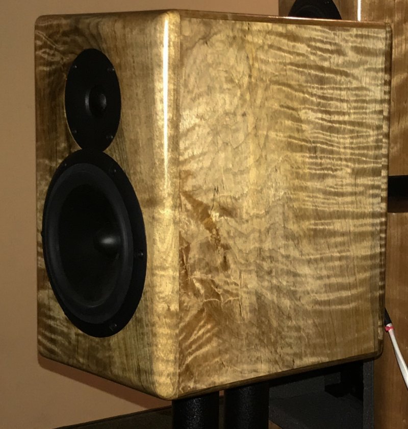

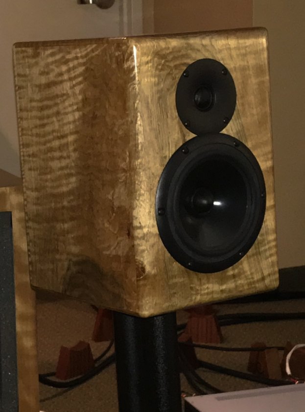

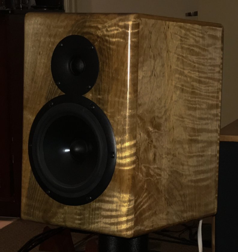

Here's a pair of X-LS Encores with 3/4" roundovers on all four edges of the front and rear baffle and 1/4" on the sides.
birkbott
  • Posts: 50
Re: Preferred roundover/bevel for cabinets?
« Reply #7 on: 22 Dec 2019, 06:46 pm »
That’s cool, did you do the front first and then the others? Or the other way around?
mlundy57
  • Posts: 3643
« Reply #8 on: 22 Dec 2019, 08:15 pm »
I did the front and back first, sides next, them smoothed the corners with sandpaper
