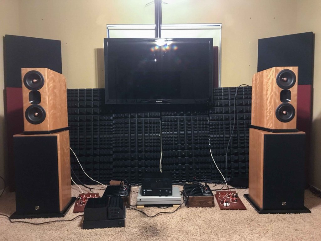

The room is 12' x 14' x 8'. The speakers are set up on the 12' wall opposite the door. The front baffle of the NX-Otica monitors is about 4' off the wall. The outside of the dual H-Frames are 18" from the side walls. The speakers are about 8' apart, center to center, and about 9' from the listening position which is about 1' from the back wall.
The TV is no longer in this position. I took down the ceiling mount, framed in the window, and installed an over the fireplace mount. When in the up position, the TV is almost to the ceiling and much closer to the window. I can easily pull it down to the position in the picture when watching a movie or push it up to listen to music. I have also removed the two outboard diffuser panels and placed them at the first reflection points.
In this room, the 4' position off the front wall has a dip in the response between 125Hz-175Hz. Moving them farther off the wall didn't help but moving them closer did. If the speakers were 3' off the front wall, the dip went away but the soundstage shrunk a little. I couldn't really hear the dip so I chose to keep the larger soundstage.
