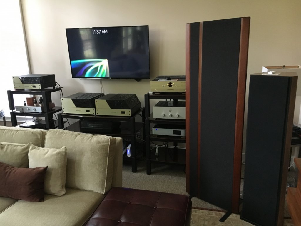

In response to a question, here's the rest of my system:
Conrad Johnson ET-5 preamplifier
Conrad Johnson Premier 140 amps (two)
Conrad Johnson MV-60SE amp
Custom VTA SP-14 preamplifier
PS Audio Directstream DAC
Thorens TD-316 TT
Grado Silver Cartridge
EmotivaXPS-1 Phono preamp
Sennheiser HD-600 Headphones
Dynaudio Gemini speakers
PBN Montana EPS speakers
Magnepan 3.6/R speakers
Mac Mini as server
