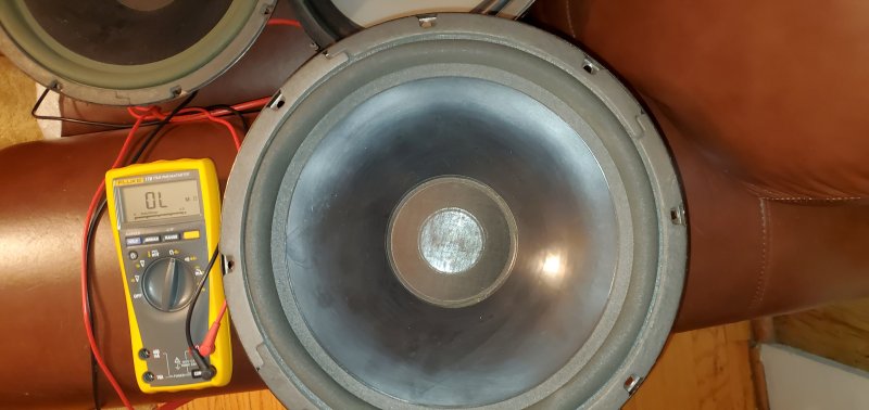

Thank you kind sir. YES I need some help with these Super Tower III speakers. Need help finding a replacement 15 inch white coned woofer and one of the 12 inch woofers is blown. Both of these have open windings in the voice coils. The wiring issue I am having is this. All of the tweeters and the mids seem to be self explanatory. The woofers are a different story. There are of course a 15, a 12, and two 10 inch smaller woofers and even those are slightly different from one another. One of them is smooth coned and the other is ribbed. All are polymer I am guessing. The problems I am having there are the wires were dangling and I have no clue what is supposed to be in series and what is supposed to be in parallel. There are also some resistors soldered to the backs of a few woofers but not sure how they play into all this. The resistors are two 12 ohm 10 watt and two 24 ohm 10 watt. Apparently one of each for each cabinet. The crossovers seem to be untouched. Is anyone willing to take a stab at this? I could sure use the help. My name is Terry. Thank you in advance.

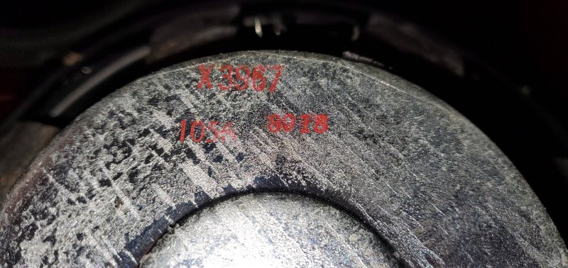

Thanks HAL.  I believe these are the suspect drivers.
15" Sub
12" Woofer
« Last Edit: 19 Nov 2019, 02:29 pm by Stimpy »

Tank you all MANY MANY times over for your help. Ok as you stated above. Enough with the noise. Lets get down to business. Number 1 thing on the list. FAILED DRIVERS. I need either a replacement for the white poly coned 15 inch Goldwood woofer OR I need to get this one repaired. If I can't get a white exact duplicate then I need to replace both so they match. One of the 12 inch has also failed. The issue with the 12 is that it is a dual voice coil speaker and the one in the other cabinet is a single voice coil and is good. It is my understanding that the single voice coil speaker is the correct one and the dual is not. SOOOOOO with that I am in need of a 12 inch that has a smooth black poly cone to match the good one I have.

By the way. Concerning the replacement drivers in the list on this site. I can live with the Goldwood replacements if they are the correct ones HOWEVER either I did not read it right OR I could not find a replacement for the 12 inch. The one good one I have measures 6.4 ohms. I THOUGHT I read somewhere it was an 8 ohm woofer as were all of them BUT tat they usually measured around 6 ohms. The replacement in the list is a 4 ohm woofer. Would I have to add a resistor to use that woofer OR is that not the correct one listed???

The 12"  DC300-8  PE Dayton woofer looks like it would electrically be a good replacement.  Very good specs, that would work well in a bass reflex design.  Efficient, good Qts, good bass response, a 6.8 ohm impedance, and very good excursion.
https://www.parts-express.com/dayton-audio-dc300-8-12-classic-woofer--295-320
Well liked by PE users too.
The 15" Goldwood woofer should be a drop in replacement for the white woofers.  Brian was using it in his subs.
https://www.parts-express.com/goldwood-gw-15pc-8-15-heavy-duty-woofer-8-ohm--290-338
Oh, about impedance readings.  Many 8 Ohm rated drivers read down around 6 Ohms.  That's not unusual.  Lower than that, and they're probably considered 4 Ohm.
15" Sub
12" Woofer
None of the images show up.
Funny, I see the images, even in your quote!   :D  Regardless, I downloaded and saved the pictures, then reposted.  Hopefully, visible to all?   :o
