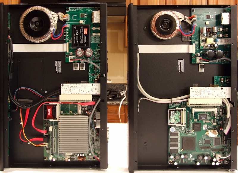

CanadianMaestro
  • Posts: 1756
Re: BDP-2 -> BDP- Upgrade
« Reply #11 on: 20 Nov 2019, 10:16 pm »
My BDP-1 produced no heat whatsoever. BDP-2 gets very hot during summer.
Looking at photos of the internals, I think comparing BDP-1 with -2 is like grapes vs oranges. Or a 737 vs. a 747. BIGGER transformer in the -2, faster processor too.
More heat. Good for Canadian winters.   :lol:
cheers
CanadianMaestro
  • Posts: 1756
« Reply #12 on: 20 Nov 2019, 10:18 pm »
Courtesy of DarqueKnight:
BDP-2 (left), BDP-1 (right).
R. Daneel
  • Posts: 1181
« Reply #13 on: 22 Nov 2019, 08:01 pm »
cheers
Yes, and very bad for Croatian summers!

Can someone explain the differences between a BDP-3 and a BDP-2 that is upgraded to a BDP-3 (if any)?
unincognito
  • Posts: 2067
    • bryston.com
« Reply #17 on: 2 Dec 2019, 02:14 pm »
Nothing that really effects the audio quality, you'll still have a BDP-2 power supply board, but the new board was really only change to meet new safety standards.  The circuit boards across the front are of a new revision, but only because we changed how the boards are ordered to help simply things for production.  Instead of have a PCB sheet that contained one or two of each circuit board to be broken out, we placed only one kind of each circuit board on each PCB sheet.  Otherwise what you get in the upgrade is what you get in a brand new BDP-3.
Chris
