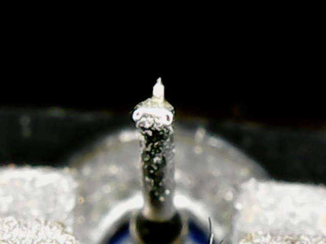

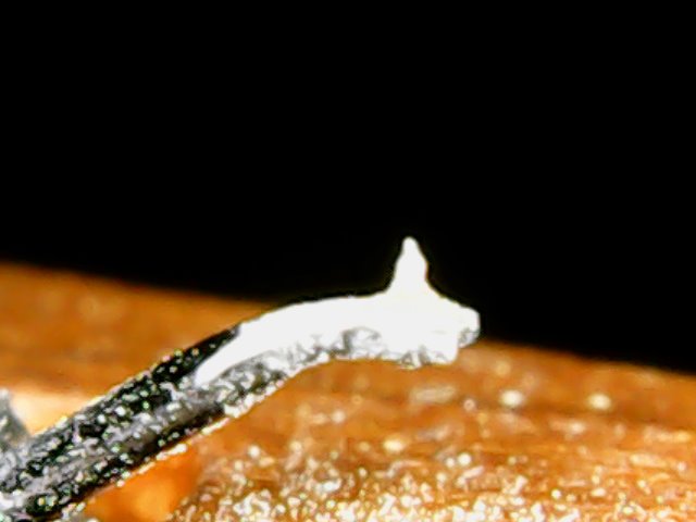

A $22 Amazon purchased just saved me $450.
Looks like my old stylus is fine.

Eeeerrrrgggghhh, no - sorry, but your pics do not show whether your stylus is dangerously worn or not.
USB microscopes are great for telling you whether the stylus needs a good clean but, unless you:
* have a 200x one,
* with great lighting
* and you've got lots of experience looking at styli
... you will not understand what you're looking at, to make a correct judgement on wear.

This thing will go to 1000x. I’ll take some 200x photos. What am I looking for?
I thought a nice sharp point was the sign of a good stylus.

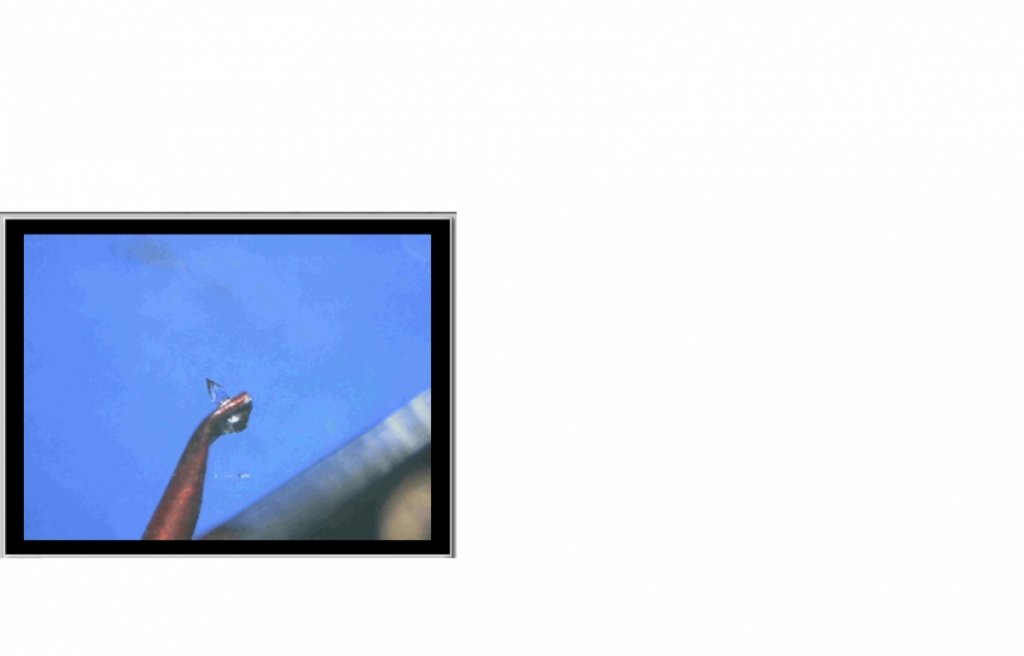

Here's a x60 pic I took of my newly re-tipped Stanton 'WOS' CS100:
That's a new stylus.  With a worn stylus - if the lighting was right - you'd see some flat planes developing, either side just below the tip.
In your case, your stylus looks so worn that you have a narrow remnant of the original stylus projecting past the end of the shank which is attached to the cantilever.

Agree that it looks badly worn.  Why not send it off for evaluation?  Steve Lueng at VAS will give you a quick evaluation and fair price.
