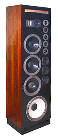

hifiguy
It is past time.
Where (should) I start?

First off - it's not a simple task. You need to really love the speaker. It won't be cheap, and you need to be pleasantly crazy :-)
That said, come up with a gameplay. Outside of cosmetics, you are most likely to deal with several things.
1) Drivers - do they all work? More than likely, they need new surrounds. (That can be done - there are lots of people.)
If drivers are bad - you need to replace all that are the same from both speakers so they match. Getting an exact replacement is most unlikely, and they won't match acoustically at this point anyway.
2) Crossover. The easiest upgrade is to upgrade the caps in the direct signal path for the mid and tweeter. Since you are going to do this, just do it the right way as you won't be going inside that speaker again anytime soon. For the sake of budget, until you pick a brand, think $50 a cap... VMPS uses 6db/oct XO's, so that's one per tweeter bank, mid bank, and mid bass if you desire.
See if those ideas help a bit. I'm sure the crowd will chime in with great ideas. John Casler is the resident VMPS man and has a lot of resources for parts.

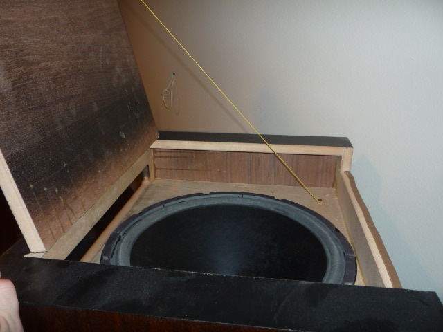

 .... also need a local 40291 cabinet / speaker repair audiophile with skills and the right power saw to cut off the top of the speakers to get at and replace the leaky PRs.
Curious why you need to cut anything open. I have Super Towers from 1981. All the drivers, including the Passive Radiator, are just screwed in. Once you take out the PR or the big woofers, you have open access to the inside of the speaker to get to any other parts or crossovers.
I built mine from a kit, back when Brians speakers were a little simpler. It was easy.
ZAKski288
Re: Considering a full rebuild for my OEM VMPS IIa/R SEs
« Reply #18 on: 18 May 2020, 04:04 am »
The top passive radiator was installed when the cabinet was built. So the only way to repair it is to cut the cabinet to remove it.
« Last Edit: 18 May 2020, 05:28 pm by ZAKski288 »
davidc1
« Reply #19 on: 18 May 2020, 04:17 pm »
Hmm....this unit was offered as a kit originally. So how did they get it in there in the first place? I would think the top wood panel above the top slot is probably glued or screwed in?
