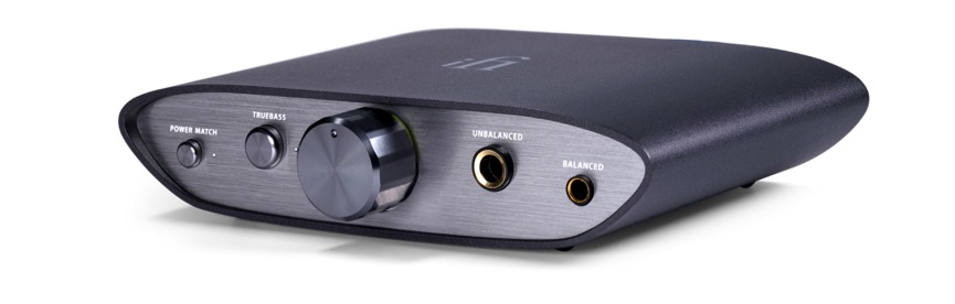

The headphone amp stage has switchable gain, which iFi terms PowerMatch. This matches the level of drive to the load presented by the headphones, by adjusting input sensitivity and thereby signal strength. With high-sensitivity headphone types such as in-ear monitors, leave PowerMatch at its lower setting for ultra-low-noise performance. But if your headphones require more drive – most on/over-ear types, for example – press the PowerMatch button on the front panel to increase gain.
TrueBass is another user-selectable feature. An evolution of iFi’s established XBass circuit, TrueBass is a sophisticated form of ‘bass boost’ that subtly enhances low frequencies without muddying the midrange – particularly useful with earphones and open-back headphones that may lack deep bass. It operates entirely in the analogue domain rather than messing with the digital signal via DSP and may be switched in or out via another button on the front panel.

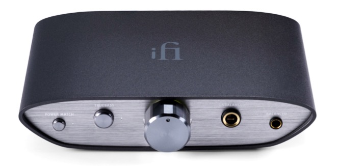

The ZEN DAC sports Pentaconn 4.4mm balanced outputs, both front and back – this is a relatively new interface type, designed to enable balanced signal transfer between compact products that cannot accommodate traditional XLR connections. The front-mounted 4.4mm output sits alongside a standard, single-ended 6.3mm headphone socket – thus, the benefits of balanced headphone designs are fully utilised, whilst also accommodating every type of headphone, both balanced and single-ended.

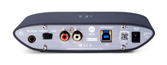

The 4.4mm output to the rear enables connection to amps and active speakers equipped with a balanced input – either a Pentaconn 4.4mm input, or XLR inputs via a 4.4mm-to-XLR cable. Single-ended RCA outputs are also provided.
These line-level outputs – both balanced and single-ended – can be switched between ‘variable’ and ‘fixed’, enhancing the ZEN DAC’s versatility. The variable setting applies volume control to the audio signal, enabling the ZEN DAC to perform as a preamp feeding a power amp or active speakers. The fixed option bypasses the volume control, fixing the output at 4.2V (balanced) or 2.1V (single-ended) for connection to an external preamp or integrated amp.
The ZEN DAC’s asynchronous USB Type B input supports the ‘SuperSpeed’ USB 3.0 standard and is also compatible with USB 2.0.
