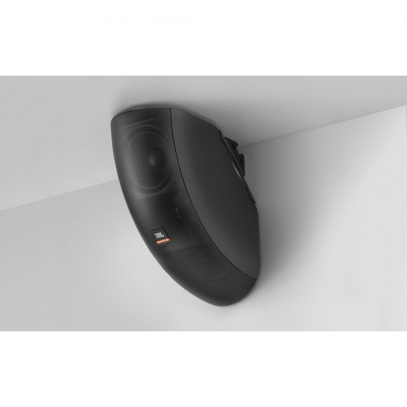

I have a home theater in the mancave and needed to install height channels. Atmos has different configurations and you don't have to cut holes in your ceiling. I went with front and rear height channels mounted high on the wall near the ceiling. Rather than choosing traditional bookshelf speakers I chose the JBL Control CRV which is sold in their professional line. The speaker is shaped on a curve  and has two 4 inch drivers with a titanium tweeter in the middle. Talk about "immersion", it is the most natural sounding setup. It is like sitting in a fish bowl of sound, you are compelety immersed. Knowing what I know now I would have installed these speakers for all 9.1 channels, not just height channels. You can install them on the wall, in corners, from the ceiling, etc. Just amazing! Here is a link to a video review and a pic. They are about $200 each on Amazon and often pop up for less on ebay. If you buy a used set make sure it includes the mounting brackets.

I have a drop ceiling also. Looking at the mounting bracket when mounting to a ceiling/wall interface the instructions show putting screws into the ceiling and the wall. With a drop ceiling putting the screws into the ceiling is a problem. How did it work for you?

Each side of the bracket has holes for 4 screws. I just attached the bracket to the wall with 4 screws and it was enough to hold the speaker. I think another 4 screws to attach to the ceiling for a total of 8 are unnecessary.
