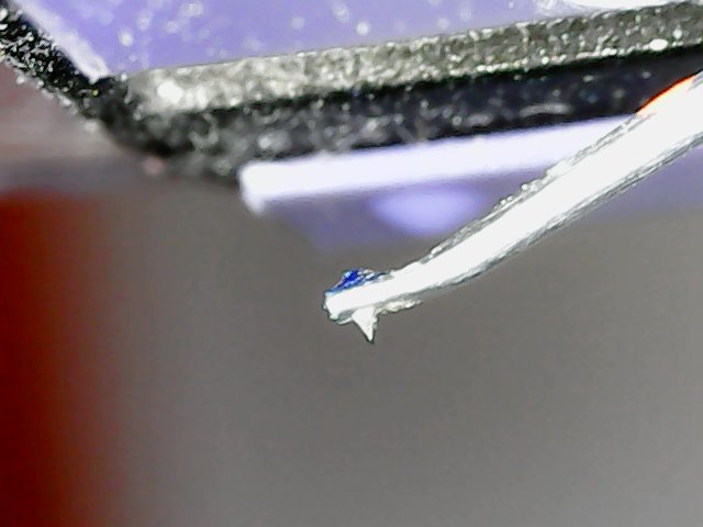

I noticed music did not sound as it should a few days ago. I couldn't really tell by eye what was going on with the stylus but it looked smaller to me for some reason. I ordered a USB microscop from Amazon for 30 bucks, pretty impressive actually. If the microscope does not work out for inspecting my stylus etc the kids will still love this microscope.
Anyways, this is what I discovered. To me it looks like my Tip is Falling off maybe?  This is an Audio Technician 440 MLa Moving Magnet Cart. I am not sure how many hours I have on it as I do not keep track, but it is at least 6 to 8 years old I would say.

Looks like the stylus has shifted or maybe there is a goober stuck to it. If you have a stylus brush try cleaning it to reveal more and maybe take a couple of photos from different angles after cleaning.

A more reasonable explanation is some gook has adhered to the stylus.
Unlikely the stylus is going 'migrate'.
So I agree the thing to do is clean it off. And yes that much junk will distort the music.  :thumb:

Looks like it needs a good cleaning with one of those dense cleaning brushes, $8
https://www.lpgear.com/product/LPSTYLBRUSH.html
The Stylus is pretty small so easily gummed up. Heat from the playing process makes it worse.
Cleaning I bet will fix it.

    Anyway, from the pic I think your stylus is still there, I see the point there and since you still get some music but distorted so it is still there. Look like you have a build up of gunge around the stylus there and this cause the stylus not to sit well into the groove.

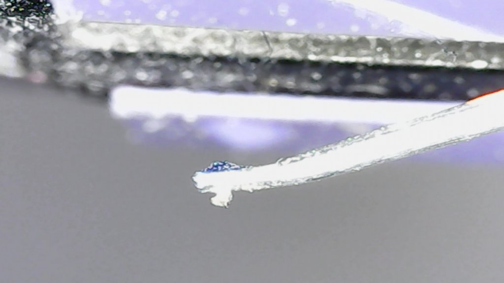

Did some investigating and experimenting with the scope. Best 30 bucks I have spent in a long time. I cleaned the stylus with my firm brush as I looked with the scope, that didn't take it off. Then I got my Magic Eraser, that took half of the gunk off. Then I got my Moon Gel (used to deaden drums) That took it all off. Sounds great now. This microscope is great for this type of thing. My kids and I where blown away looking at stuff this afternoon. Just dont look in your ears like I did  :o
