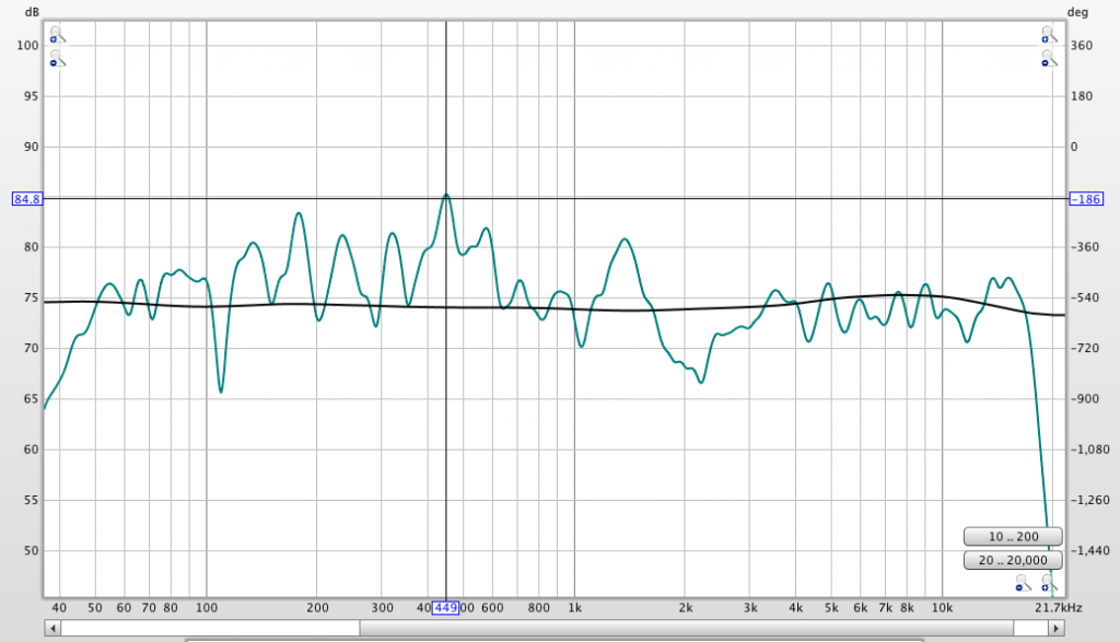

It's not a flat 2-3db dip, more like a sine wave of ups and downs all the way till 10khz. At 2500hz there was a 3db dip, but more severely from 1800-2200hz, where it drops as much as 4-7db.
What makes it so much more prominent is that across the mids (300-600hz), there are peaks of 5-10db...
Can you post an image of your measurements? I’m not an expert on this subject and I know in room response isn’t the same as anechoic, but I do recall Danny/GR Research saying something about measuring a speakers FR and that most people get it wrong.
Nonetheless I’m not doubting what you have found. I can hear certain tonal anomalies but I find the prevalence of those aberrations really depends on what I’m listening too. Some speakers are more linear than others and those that deviate more, especially in the mids never seem to sound right no matter what’s played. I do not find that to be the case with the M3ts.

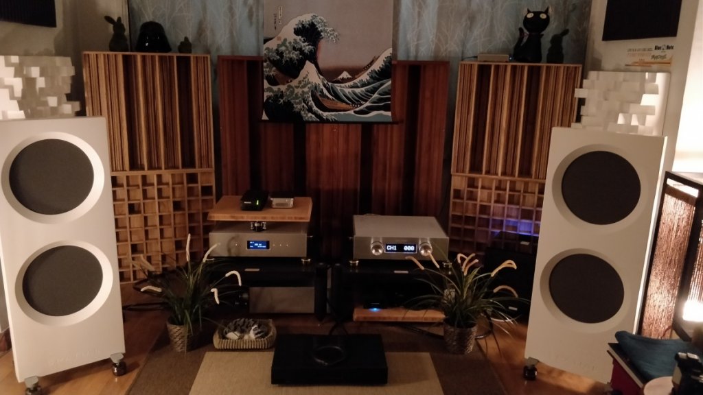

Attaching a picture of my setup and the measurements, done using REW with the umik-1 mic. I know measurements are one thing, and they are being affected by my room/equipment/cables etc. Despite all that, I still think the m4tm does a lot of things right and it is still going to be with me for awhile (till I bite the bullet and get the x5)
As an REW user, (and previous owner of the M3TM's), I believe your measurements are being heavily influenced by the room.
 Open baffle speakers are difficult to measure accurately to begin with, but most any speaker needs a minimum of 6ft to the nearest room boundary to get even close to accurate results.
 Your results appear to be affected by "comb" effects. This is, at least partially, due to the gating used during data collection. ARTA is a bit more flexible with gating than REW. Thought REW does allow you to change the gating.
 I don't currently have access to my M3TM measurements, but IIRC, there was a mild depression in the midrange, but they had generally smooth response. Are your measurements at 1 meter, on axis, or at the listening position?
 Morgan, sorry to sidetrack your thread.
 - Rick
Hi Rick, thanks for your input! These measurements are done from my listening position. To everyone, these are NOT the actual response of the M4TM in an ideal measuring environment, on axis. This response is unique to my room, and its acoustics. I didn't overly smoothen the graph as I was trying to capture what I was facing in a 'real world' environment, with reflections and whatnot.
The other M3TM I heard was with listening position against the wall, speakers about 2ft from the front wall and sides that extend down the corridor, vastly different from my closed room setting. However, there was still that dip when it transits from the high mids to highs. Nevertheless, I will try to reach out to other Spatial owners in the country and see if I give their setups a listen.
Would you be able to suggest what I can do to improve the sound I'm getting? I've tried pulling the speakers further into the room, or closer together, added foam panels and whatnot, but every gain resulted in loss in other areas. This current position seems to be the best compromise, but if anyone has any suggestions, I'm all ears!

 One quick suggestion. Try using the REW "monitor" function and use the pink noise generator. That way you should be able to see the live response, and "usually", a more accurate depiction of what you are hearing. REW is a great program, but can be a bit tricky to set up. Another "educational" exercise that can be a surprise experience is, use the signal generator to produce a 35-40hz tone, then walk around the room while it's playing. The null and resonance "zones" can be an eye opener if you've never experienced it.
 Also, when moving the speakers position, I typically ignore the measured response, and go by my ears. I try to be very methodical with measurements (distance wise), and find that a half inch one way or the other can go from "meh" to VERY good.
