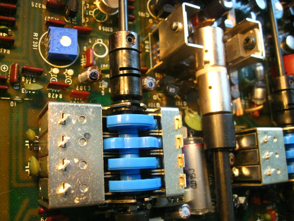

Back in the real world where resources are finite my fantasy gets rained on. The first issue is the TA-x86B components are 30 to 40 years old. Every single electrolytic capacitor is aged out. Reliability and noise and really hearing what the designers intended demands they be gone through and replaced. Perfect job for a retired electrical engineer or senior technician who can deal with both sourcing correct parts and soldering on decades old circuit boards and is not being intimidated by (but respects) the complexity of the circuits. Paying to have that done I would advise very careful vetting of who will do it and expect to pay $1,000 per unit. Someone will object to that cost (because Internet) and I invite them to consider this view of the Sony TA-E86B interior. I see perhaps 50 caps that need to be changed. Depending on region/country shop labor rates need to be $85 to $120 hour to keep a business open.
Now well and truly down the search engine rabbit hole here is a thread on a German site about restoring a TA-E88 and a circuit board close up from the posts that for me as a circuit designer is pure audio porn.
https://www.analog-forum.de/wbboard/index.php?thread/105352-sony-ta-e88-%C3%BCberholung-eines-klassikers/&pageNo=1
Oh, be still my beating heart. The first thing I see is the other cautionary note, so many custom unobtainable parts. The bright blue plastic cams are part of a selector switch, unlike any I have ever seen. In the first photo above note there are 8 (!!) of these beauties. We also see the shafts and universal joints allowing the switches to be on the PCB located where they are needed in the circuit flow yet connected by long shafts to the front panel knobs. Note (reading upside down) C307 and his mate other side of the shaft small electrolytic caps that age so unpredictably. But then my mind was blown and I saw an example of why these are so revered. Look at R428, what the heck kind of resistor is THAT?!?? And they are all over the board!  In that odd rectangular package dipped in brown epoxy my guess is Vishay etched film 25 years before anyone in audio had heard of them or Japanese tantalum resistors. So worth the hours and dollars to keep going if you have the resources and passion. In 2019 the only products I see with this level of quality and circuit density on the PCBs are Boulder and Soulution Audio, and those are stuffed by robot pick-n-place machines. The Sony was built by hand by a master craftsman, or more likely craftswoman. To duplicate this TA-E88 in 2019, it’s a $25,000+ pre-amp.
