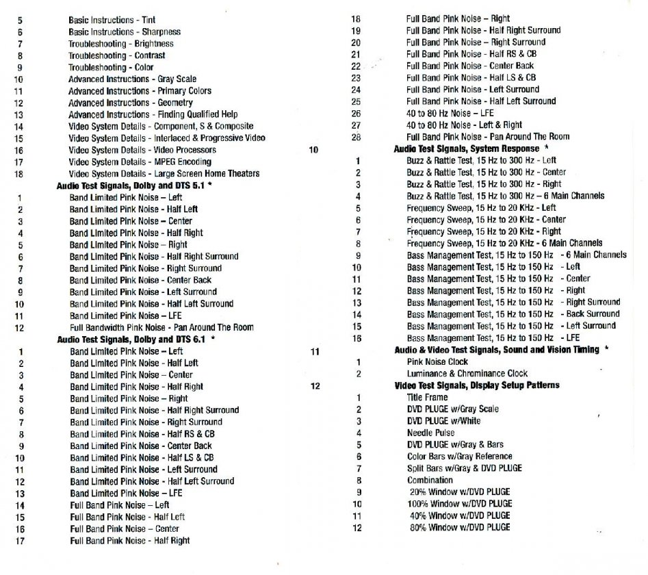

WGH
Re: 5.1 Audio Test CD?
« Reply #6 on: 14 Aug 2019, 05:31 pm »
I'm not surprised you didn't find the sweep, the Digital Video Essentials DVD has the worst menu and navigation system ever designed by man.
The frequency sweep tests are under #10.
Note: the sections with the * are DTS encoded, you will have to change the audio selection to access these tests.
Hope this helps:
