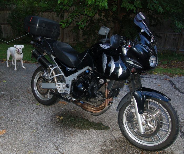

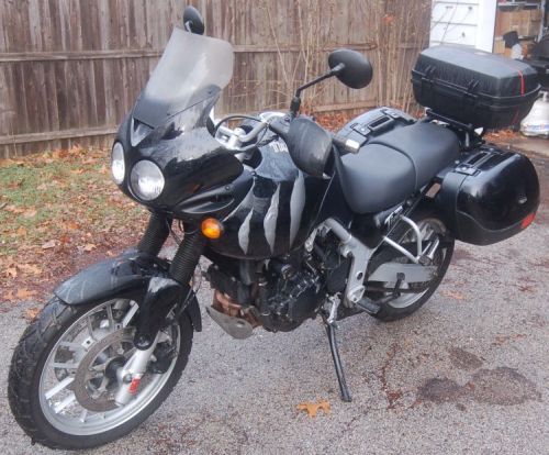

A few years back I purchased a 2006 Triumph 955i Tiger on Christmas Eve from a fellow in NYC as a little present for being such a good boy.
At least someday thinks so. That would be me.
Here it is the day I got it.

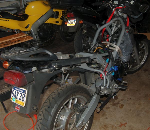

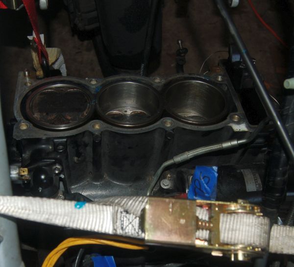

Off comes the everything in sight and it's down to it's skivvies.

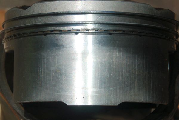

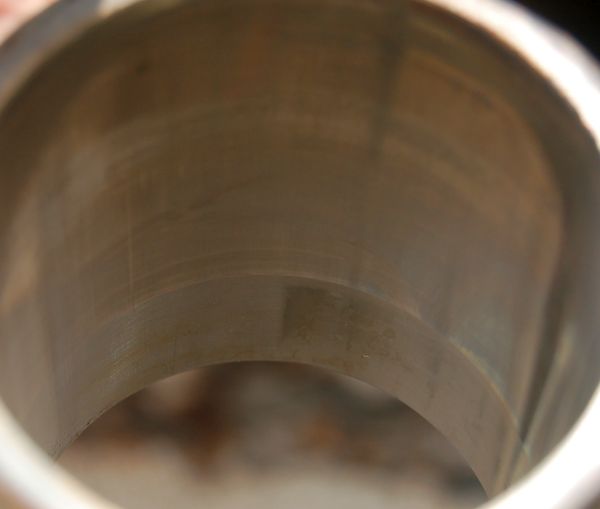

And it looks like the oil consumption problems aren't confined to just the evil Cylinder One.

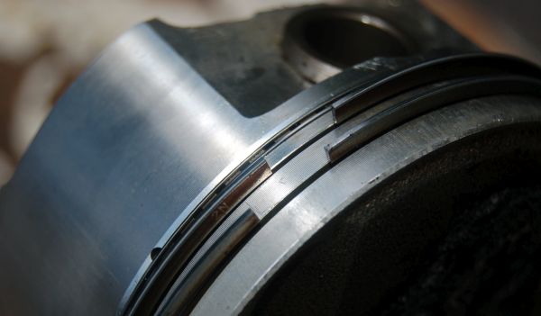

The evil Cylinder Numero Uno sucked in a bunch of sand just like I suspected.
and the compression rings were lined up.

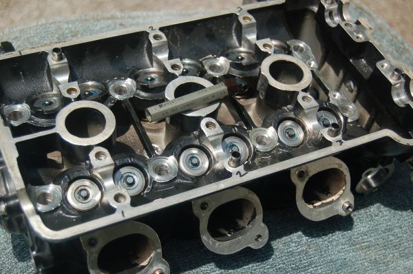

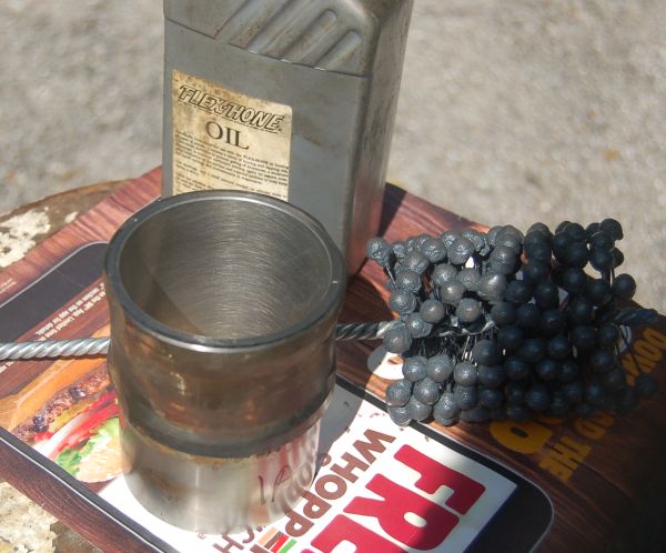

I stripped and cleaned the heads, lapped the valves, put on new valve guide seals and got to put on 24 tiny little valve keepers. Fun with grease, indeed.
Then I ran a Flex Hone through all three cylinder liners and installed the replacement piston and 3 sets of rings.

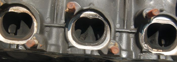

On with the head, the valve shim buckets, the cams, the timing chain, the fuel rail, the exhaust, the radiator, the oil cooler, the this, the that.
New plugs, cleaned and reoiled the K&N, new coolant, new filter, new oil, hooked up the wiring, hooked up the tank, went to start it up and off with the tank, reseat the radiator cap, reseat the ignition coil wiring and success!
