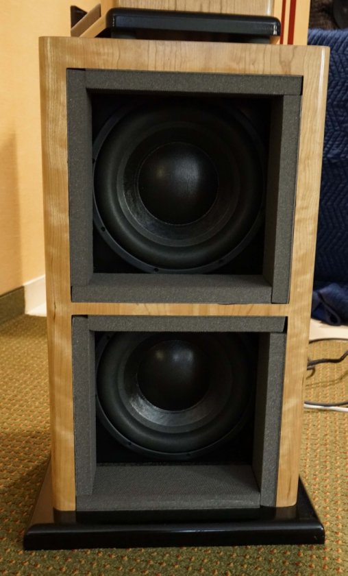

AvsFan
  • Posts: 905
Re: "Should I add a subwoofer to the LRS?"
« Reply #11 on: 29 Jul 2019, 09:44 pm »
For an open baffle speaker, you really want an open baffle sub.  The "speed" you hear from OB speakers has to do with how they interact with a room.  It's the same with a sub.  No box sub will ever integrate as well with an OB speaker as an OB sub will.  Check out the GR Research offerings on this site, they are pretty spectacular.
Thanks for the info.
 :popcorn:
Would something like this work?

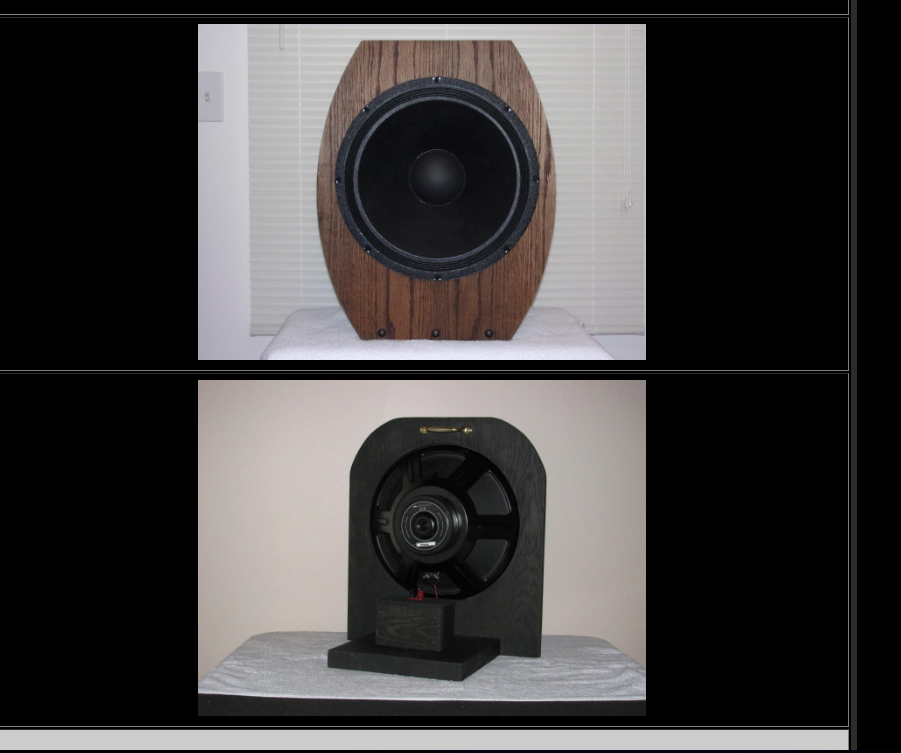

  • Posts: 11647
« Reply #15 on: 29 Jul 2019, 10:59 pm »
 :popcorn:
That would be good.  But a pair of these would be much better:
