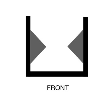

Can anyone hazard a guess what the radiation pattern for an OB woofer section in a U frame with dual side-mounted woofers might be?
Like this:
And any advantage over a regular U frame?

Assuming the woofers are wired with the same polarity, it will likely throw an irregular figure eight pattern, which often requires more complex correction to address phase abnormalities. While you might be able to make an argument for force cancellation in a sealed enclosure, this would have little benefit in an open box.

What might be more interesting is an experiment wiring the woofers in push-pull. You would likely wind up with a dispersion pattern similar to that of the single woofer Gradient Helsinki. Many people seem to like this speaker.

You would still wind up with an asymmetrical radiation pattern with heavy cancellation in the rear. This design seems to be purpose built as stands for mini monitors that are placed close to the front wall. The best sounding systems that I have heard seem to strive for symmetrical radiation throughout most of their range, along with ample space from room boundaries.

The radiation pattern (cardioidish>dipole) is frequency dependent, including of course the baffle size. I have measurements somewhere of a design (from 2012ish) that used that exact layout, so I'll try to dig up for you.

At lowest frequencies, because the baffle size is small relative to wavelengths, yes, or close to as much.

Essentially Cardioid but with 2 rear off-axis nulls.
The nice thing about the rear nulls is they reduce the bass boom effects from the rear corners of your listening room. This can eliminate or at least reduce the need for rear corner acoustic treatments.
The design also increases bass SPL compared to a simpler finite open baffle design.
However, I'm not a complete fan as, IMO, some of the impact and openness of open baffle bass is lost in this configuration.
I've experimented with H and U frames but I keep going back to a planar baffle with a combined Fc of about 200Hz - then actively equalize.

Unfortunately Danny Ritchie built a pair and found they operated more like a slotted port.

Most proponents of this set-up keep the shared air mass between the woofers to a minimum. There is a limit because you don't want the "port" air velocity too high otherwise chuffing (and distortion) will occur.
The offset design probably introduced additional reflections, turbulance and high air mass. Maybe this is why the results weren't so good.
