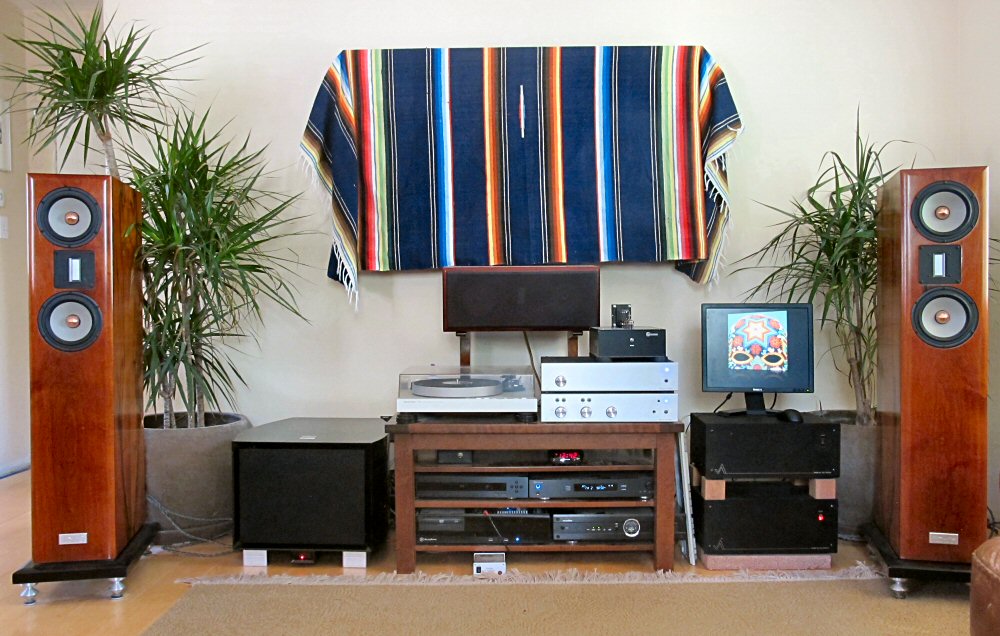

My HT2-TL does have the LCY tweeter. Has anyone had their LCY tweeter upgraded to the RAAL? It doesn’t look so straight forward. I also have the giant gliders from Herbie under my speakers. As I stated earlier I’m exploring possible tweaks or upgrades. A friend of mine recently let me borrow his Daedalus Ulysses speakers and I liked what I heard from the higher efficiency speakers. A lot more detail but a lot more pricey as well. My first attempt at loading a photo, hopefully it works.

Well, actually, we could do an upgrade.  We wouldn't need to replace the front baffle.  It turns out that the LCY has a 110mm round faceplate and the RAAL has a 110mm square faceplate.  We would have to take the cabinets in, re-route the front baffle and replace both the tweeters and the crossovers.  So it would be expensive, but it can be done.  As to whether or not it would be worth it, that is a question I can't answer.  I probably wouldn't if the speakers were mine.
