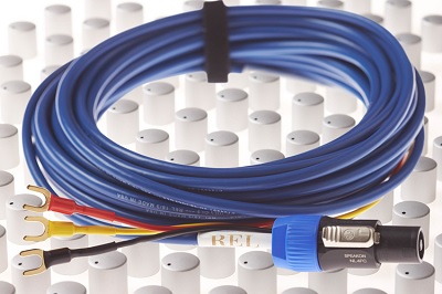

WGH
Re: Amplifier to subwoofer connection
« Reply #13 on: 17 Jun 2019, 11:44 pm »
The exception is the REL subwoofer, which recommends the speaker connection over the line connection for their subwoofers.  This was echoed by PS Audio for the same reason as to send the signal to the subwoofer with the same sonic signature as the main amplifier.
I tried both methods with a non-REL subwoofer with standard speaker binding post inputs and couldn't discern a difference and wasn't all that surprised only dealing with a 20Hz-80Hz range.
But if I had an REL subwoofer, I would probably try the comparison again, because ..... who knows?  ;)
BTW, my system always sounds a little smoother and engaging when I pour a glass of my favorite libation.  One of the few tweeks I use.
I have a REL G2 and use the Neutrik connection, never tried just a line input, it will work but not recommended:
"The high-level, unbalanced, dual-channel (stereo) input is via a Neutrik® Speakon® connector is designed to
accept the stereo (two-channel) signals from the speaker terminals of your receiver, integrated amplifier or
basic amplifier. This has the advantage of ensuring that your subwoofer receives exactly the same signal as
the main speakers, which means that the character of the bass from the main system is carried forward into
the Sub-Bass System.
This is a very important point and together with REL’s Natural RollOff™ circuitry, ensures far superior system
integration of the Sub-Bass System with the main system."
Since the REL is a sub-bass my crossover is set at 28 Hz and blends seamlessly with the Salk HT2-TL which starts rolling off at 34 Hz.
srb - you are welcome to stop by to check out the REL (with libations), it has strong bass to 18Hz, the soundstage on live recordings opens up when you can hear the room.
