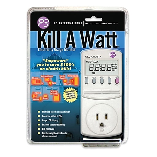

You would be surprised how few amps you really draw. Spend $30 and get on of these to find out for yourself
5 years ago I measured barely 3 watts being pulled form the wall for everything at full tilt (stereo).

I regularly use one of these "Kill A Watt" meters to get a rough idea of the idle and full tilt current draw of my devices.
https://www.amazon.com/P3-P4400-Electricity-Usage-Monitor/dp/B00009MDBU
It is cheap, easy, and quite educational. Most of this gear draws very little current most of the time. Not enough to kick a breaker unless something is seriously malfunctioning, which is the intent of circuit protection.

Ah, thanks for mentioning that. The Torus rep also suggested that, so I guess I need to get one since it seems to be a pretty consistent recommendation.
