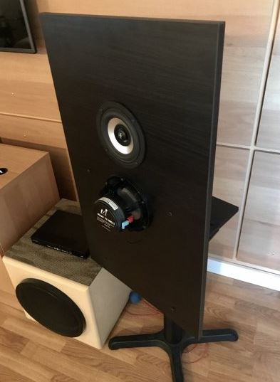

Hi,
It's been many years since I designed and built the original Hestia project. Perhaps a decent way for someone to get into the hobby. Also take a look at the Martin King open baffle projects on his website. Martin makes very smart design choices and can back it with the science. I have always found his conclusions to be very helpful.
My last few designs have centered around smaller fullrange drivers on open panels (Jordan Eikona/Mark Audio) and properly implemented subs. For my tastes, this combination works well.
