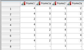

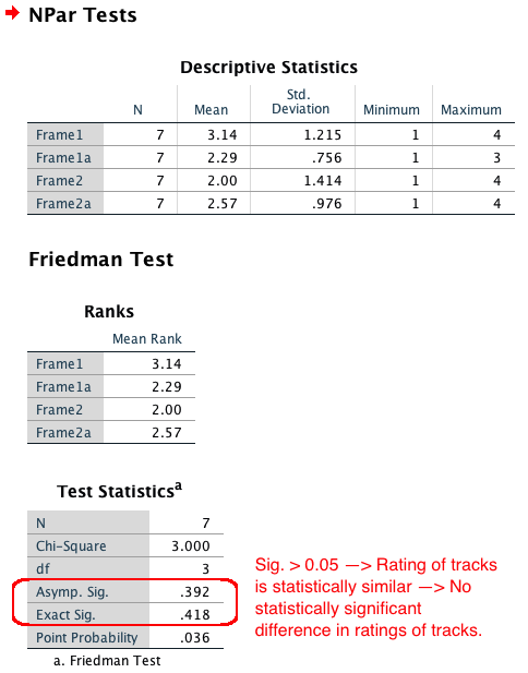

Sorry to burst your bubble, but your results aren't statistically significant. I plopped your data into SPSS and ran a Friedman Test (K Related Samples test). The results of the test indicate that there is no difference in the ratings of the tracks. In fact, there's a 41.8% chance the ratings are exactly the same. Most scientific research requires 5% chance or lower (p ≤ 0.05) to be considered statistically significant.
Participant #8 was excluded from the analysis as they only provided one data point.
Tom

When the results shows 8 out of 9 hearing a difference, I don't consider this a null result.
When a majority of listeners select the same track as the best track, I don't consider this a null result.
You have to consider that every system and software is different.  Nothing here was controlled, and yet these results are still compelling.  It may not meet the standard of statistical significance, but it's a lot better than just a few anecdotes, which is what we had before.
