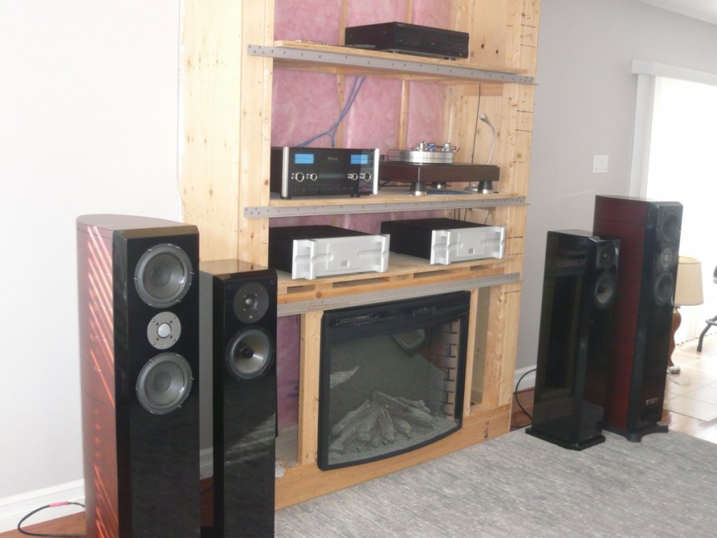

I was clipping my 4B3 amp into a FS-788
So i got the 7B3
All is good
Looking at a second speaker mini dancer 2 rated at 120 watts
Will my 7B3 amps kill it
Room is 30 x 28 ft

If the cubed 7Bs solved your problem with clipping a speaker that Soundstage measured at 84.5 dB sensitivity I think they will do just fine with the mini dancers which I read were rated at 90dBs. Say you were to listen at 99dBs which is pretty damn loud. You'd need 24 watts to get the 788s that loud and only 8 watts with the mini dancers to achieve that sound level. One would assume that the amps will be working with less strain on them with the mini dancers.
You have more than enough power to blow up either if you chose to but likely you won't abuse them to that level.
