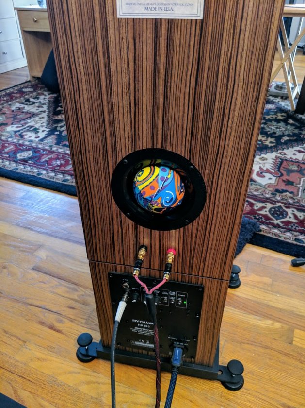

Hey just realized that this orb mini fits in my HO SAMs. I only have one so I can't comment on the sound but I'd like to try.
https://www.amazon.com/Pro-Tec-Athletics-Extreme-mobility-massage/dp/B01N213PGX/ref=sr_1_3?keywords=orb+mini&qid=1553978942&s=gateway&sr=8-3
