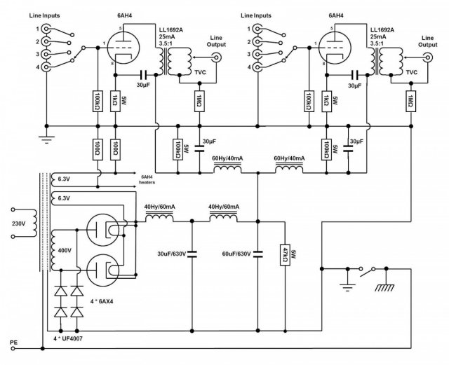

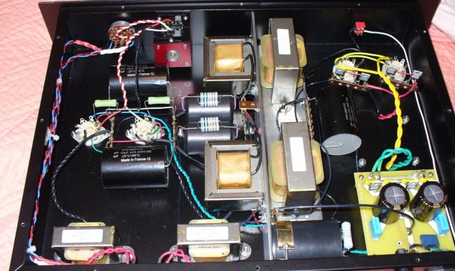

I've owned a lot of gear over the years, but this tube preamp design is perhaps the best overall preamp (tube or ss) I've come across:
While better designed gear sounds more similar than not, regardless of what anyone tells you, tube gear does sound different than SS.  Most musicians who play guitar will tell you that their SS emulation amps DO NOT sound like a tube amp.
