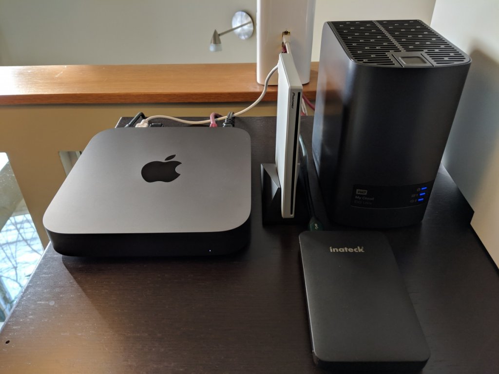

What do I use? I have a WD MyCloud EX2 Ultra (NAS) with a pair of 7200 rpm, 8TB disks in RAID 1 mode (mirrored), which are periodically backed-up to a direct attached Drobo RAID 5 array using software that enforces a CRC check on each sync, to detect bit errors on the source and copy.
The NAS is accessed via SMB 3 with wired Ethernet by a Mac Mini running Roon Server (1 Gigabit Ethernet), all located away from my audio gear (see photo attached). The Mac Mini w/ Roon Server connects to my remote BDP-1 via a wireless bridge (Apple Airport Express), which is itself connected to the BDP via 100Mb wired Ethernet. This is another way to achieve isolation between the BDP-1 and the remaining devices on my network.
I have my BDP-1 connected to the wireless bridge via a 3 meter Ethernet cable, so the wireless bridge (which itself emits a fair amount of EMI/RFI) is far away from my audio gear.
I find that even with 192 kHz / 24-bit audio tracks (Roon uses my AIFF lossless iTunes library and playlists), the 100 Mb wireless connection to the BDP-1 is *plenty* fast for lag free playback (i.e. tracks start instantly when I click on the play button, without any stutter, even skipping around my library as fast as the Roon user interface will allow). The Bryston RAAT implementation on the BDP-1 is quite good, compared to other devices I have auditioned (which *do* struggle with lag-free playback).

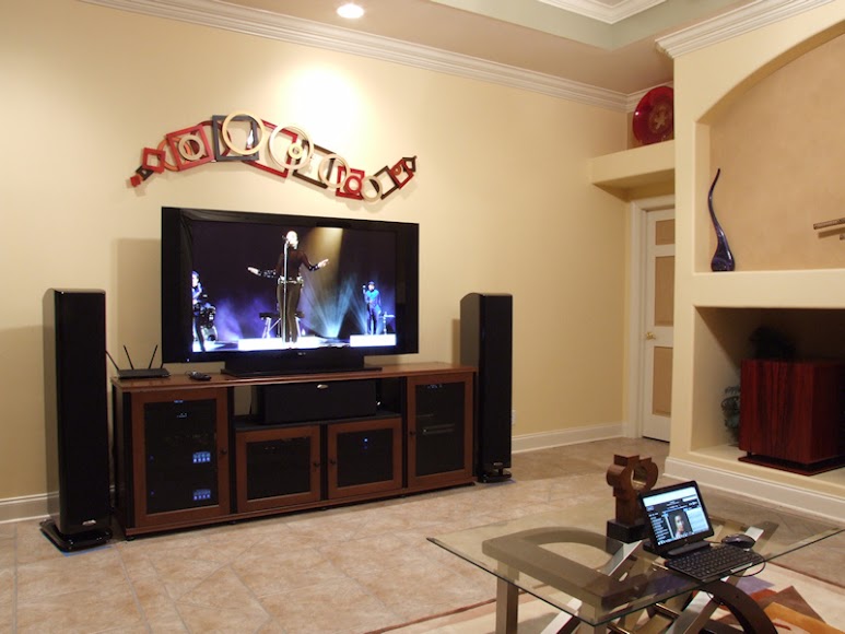

I use a Synology 918+ NAS in my home theater system with four 8 TB WD Red drives in JBOD configuration for my video collection (ripped DVD and Blu-ray). I use 8 TB WD Red drives in external enclosures for back ups.
An older picture of my home theater setup. The only thing different now is the Pioneer Kuro 60" plasma has been replaced with a 65" LG OLED television.
The entire system is controlled by a combination of a Harmony universal remote and the docked tablet computer on the coffee table.
The Synology DS918+ NAS is on the center right middle shelf.

The picture quality of my movies from the NAS is sharper and clearer than playing them from physical media. I realized a similar benefit when I ripped all my CDs and SACDs to digital files and abandoned physical media playback. I have wondered if there would be further audio quality improvement by serving music files from a NAS. It is definitely on my list of things to try...after I finish all my experiments with external drives, internal drives, external enclosures and enclosure power supplies. I like to try different approaches to see and hear what works best in a particular room and system.
I have added the WD MyCloud EX2 Ultra to the list of prospective NAS units for my stereo system.
