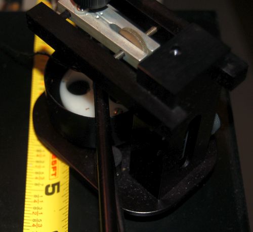

I have a customer with a Well Tempered Classic that has been closeted for a few moons.  I was hired to bring her back to life and have encountered a few issues.  The well that holds the 100,000 cts silicone has come unglued from the arm base and thus rendered the arm impossible to set up.  I would like to know if anyone can provide the correct positioning of the damping well on the arm plate so that I might clean off the old adhesive and re-glue it in the proper position to allow for correct set up. Even is some kind soul might measure the distance from the edge of the well to the edge of the bottom plate of the arm on their own working arm.  Also the anti-skate thumb screw seems to move the arm in non linear fashion.  As in it does not always move the 2 silver centering bars when spun.  I would like to clean out all of the old silicone and replace it with new. Can anyone advise how to remove the old silicone?  Any advice would be appreciated.

The anti skate on my two tables works best with the bars fully closed and you can swab out the old goo with paper towels.

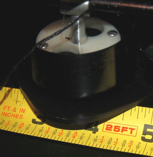

Here's some pics, hope they help.  Looks like mine trapped an ant at one time, maybe time to do some housekeeping...
I can't recall exactly where it is but there's an Allen bolt buried around there which will keep the azimuth adjustment steady.

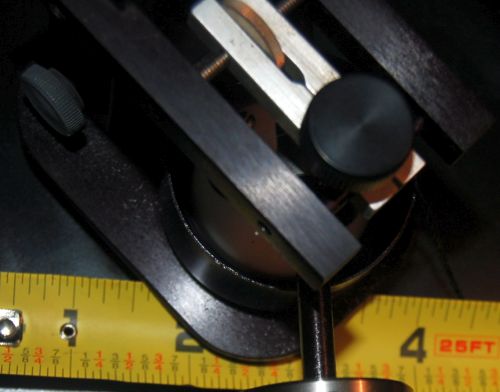

Thanks a ton for the images.  If it is not a hassle, can you measure from the edge of the cup to the end of the lower plate.  It looks like the cup sits closer to the rear of the plate than the sides.  In the image below I need the distance between the white ( poorly added by me ) lines.
SteveFord
  • Posts: 6527
Re: Well Tempered Classic Arm has some issues
« Reply #3 on: 17 Jan 2019, 01:51 pm »
Using the previous picture, the arrow at 3:00 is .195"
the arrow at 12:00 is .280"
even though you didn't ask for it, from the outside of the armrest rod to the cup is .478".
An interview I read said that these were assembled 100 at a time by hand so my guess is they eyeballed where it would look right and pressed the cup down.

It's a hard thing to take good pictures of but it looks like the cup on the one you're working on was pretty much in the right spot.
