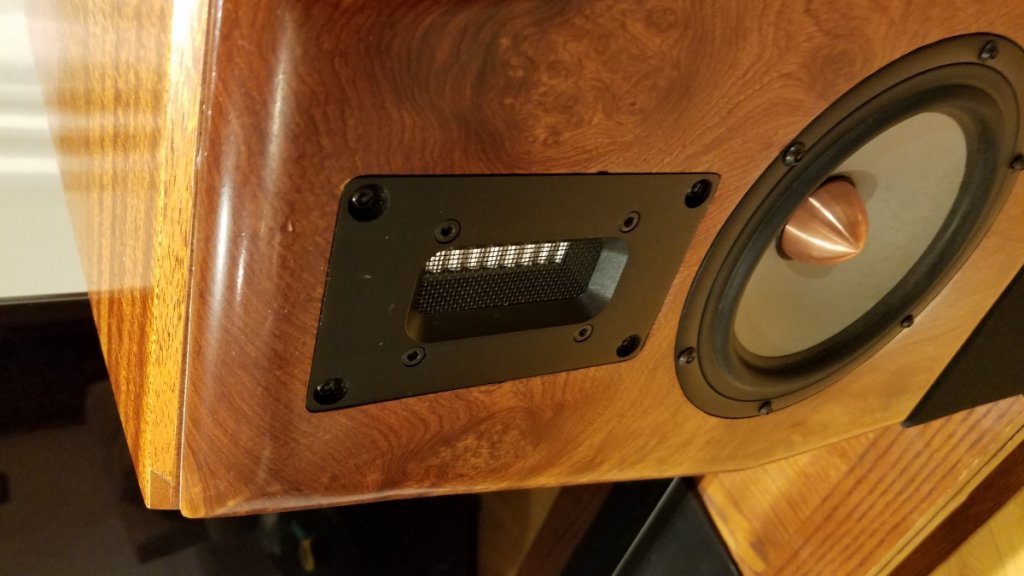

I have had my Salk HT3s in the basement for the last 5 years or so.  My other speakers (Linn 5140s) broke, so I moved the Salks into their place.  This is the tweeter on one of the speakers:

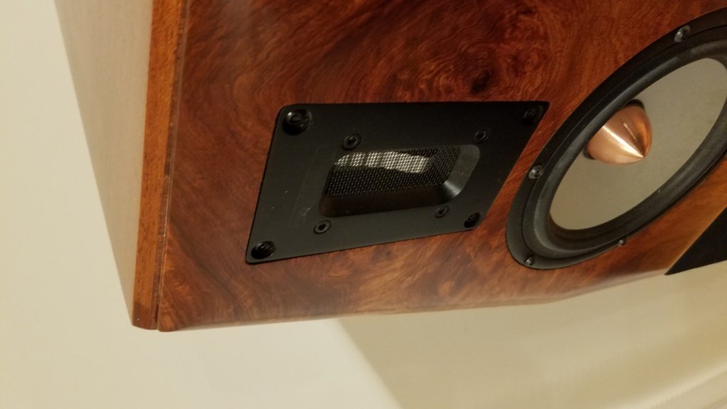

Compare with the other HT3 (and the HT3 center looks like this too):
Is my tweeter bad?
I am still configuring the system, so I cannot play the speakers until sometime this weekend.  And even when I play them, I'm not sure how to test to see if the tweeter is bad.
Thank you.
(Hmmm...I have no idea why they are rotated, but you can still see the important part of the images.)

The tweeter element has stretched, so yes they are bad.  Good news is that’s it’s a cheap and easy DIY fix.  Contact Jim Salk for guidence.  This same thing happened to both my HT3’s.  I purchased new elements for about $6 each, but to practice replacing them, I simply stretched the old ones a bit.  It worked perfectly, but I put new ones in anyways.
I have pics somewhere...

Ok, the pics are in my gallery under "Salk HT3 Tweeter Repair."  The 3rd pic shows my original stretched element pulled tighter and reused.  Later, I installed new ones.  I do not think the stretched element sounded any different from the new ones.  You need to handle the elements with extreme care.  They are micro-thin and tear very easily.  I never tore any, but the ends are taped in place, and removing the tape is the most critical part.
You can buy new elements from Parts Express.  Just search "Aurum Cantus G2 ribbon replacement" and you will find them.  Jim suggested I order extras, so I ordered 4 of them.
Let me know if you have any questions.  I will try to help as best I can.
TJHUB
Re: Is my tweeter on my HT3 bad?
« Reply #5 on: 16 Jan 2019, 01:17 am »
Also, the tweeter faceplate will likely be stuck to the speaker baffle.  An easy way to break the free without having to pry against Jim’s beautiful finish is to take one of the wood screws and hook it in the tweeter screw hole at an angle and pull gently.  Worked for me.  Also be aware that metal screws and screwdrivers are not easy to work with around very strong magnets!
