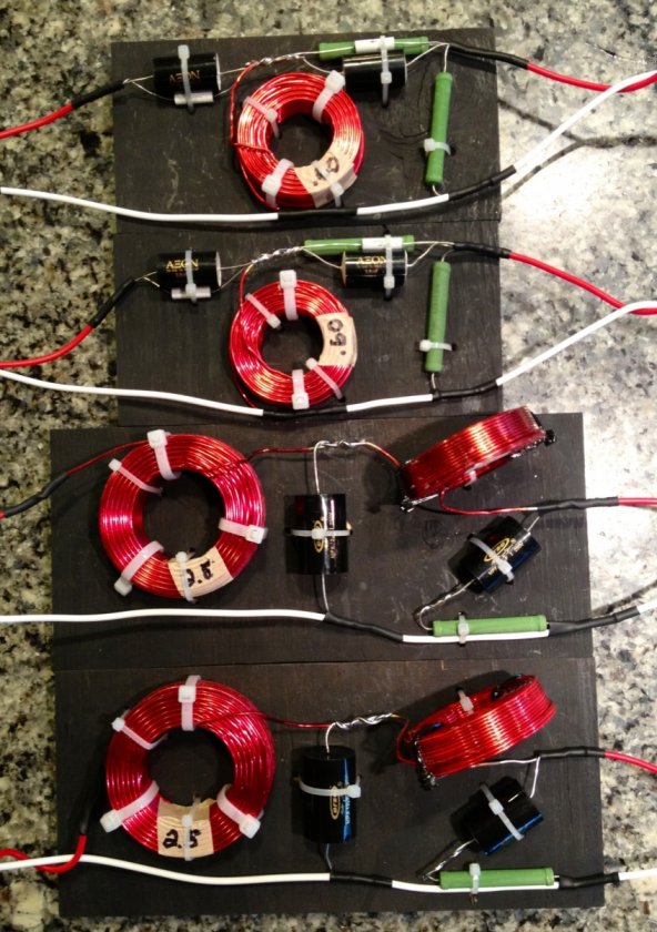

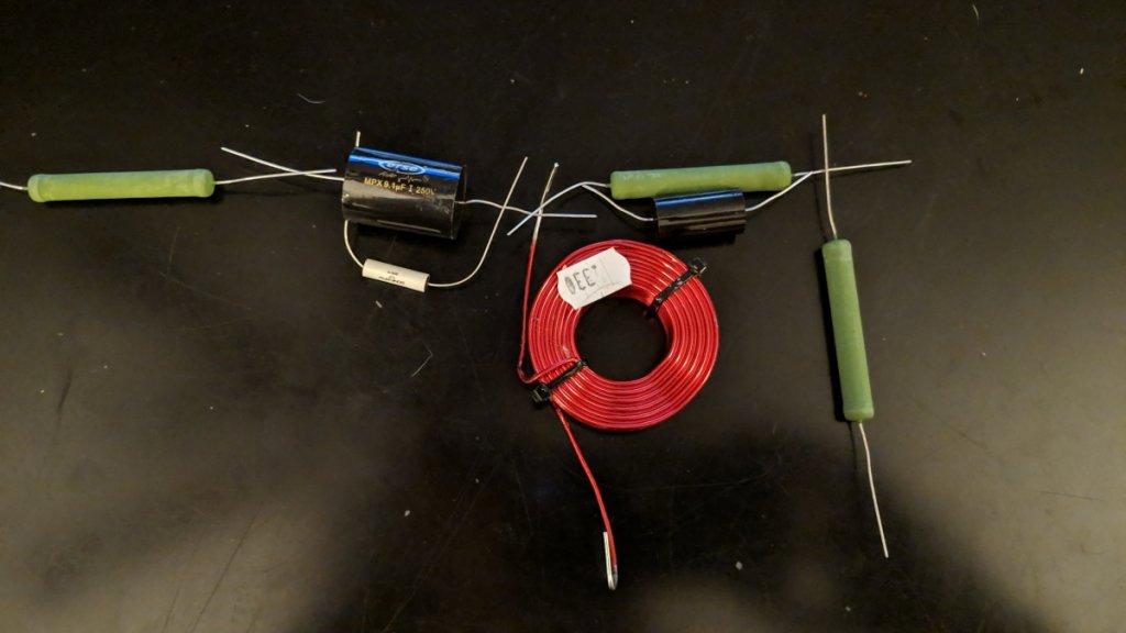

Ok, so double check this, please. Yes yes I know, I don't have the red and white positive and negative wires in this yet but from a rough layout, is this correct? Meaning, do I need to flip anything around, make certain pieces vertical instead of horizontal? It's been a long time since I've built a crossover so forgive the newbness :D
Tweeter circuit:
Woofer circuit:
Here is a crossover set I built for a different set of bookshelf speakers so forgive the rudimentary nature of this layout thus far. I need help to get to where I need to be and have them look nice!
« Last Edit: 30 Jan 2019, 04:22 pm by skeeter99 »
Just be sure not lay  the inductor  from the high pass (tweeter) circuit on it's side   close to the   low pass inductor on it's side..... better  to stand the small one up   and orientate so that if it were to roll, it would roll right into the center  of the large inductor on it's side
there's  a diagram in the crossover 101  sticky you  can refer to if the above  doesn't make sense
Personally, I'd  also add a .1 uF bypass cap tothe  cap in the low pass  both the Sonicap G2's  and  vishay Rodersteins  are   inexpensive and  both work  well, for the  few  bucks it's  worth  it
jay

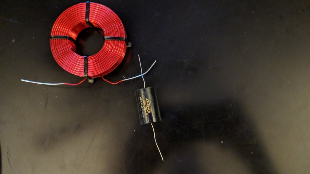

Ok, so showing my newb, the inductor is the big copper coil right? Just place it vertically? I was figuring I'd have to do something like that ...
These are the parts Danny sent me. What would the bypass cap on the woofer circuit do?
yeah,    each  leg  has an inductor, the   coils....   stand the small one up  and  orientate as I  noted above.
the bypass caps just help  discharge/charge rates of the  larger  caps.
Looks like you've already got   a g2  wrpapped around the high pass cap,  I'd do the same  with  the low pass  cap..  You don't have to, but  at a totlal cost of  <$10,   .....  I never hesitate to add them
jay
Ok so does the X-Voce have the bypass on the woofer circuit too. I've got the X-Voce for center now and the closer I match the two the better.
