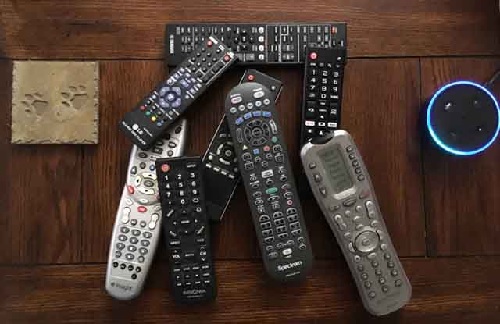

Interesting. It has RCA out. How many TV’s don’t have an analog out?
I would guess and say ..... more than half, maybe 75%?
IMO, this day in age, it is ludicrous to even consider something that requires another remote.
I don't really see the problem  ;)
