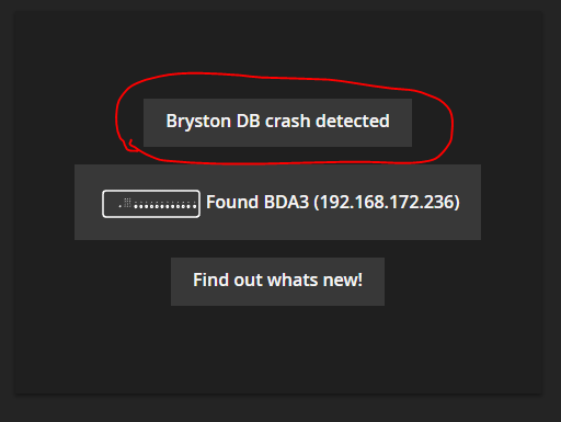

If you go back to the dashboard does it indicate that bryston db has crashed?

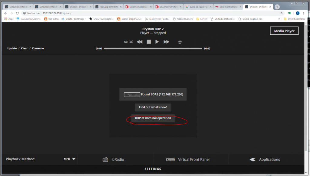

Below is what the dashboard view should indicate when everything is all hunky dory
if rebuilding the bryston db never completes the dashboard will display this message
As of S2.38 if you have the Bryston DB is turned on and your using the default view it will want to display cover art in place of the generic folder icon and if rendering the contents of a folder/path takes more then 3 seconds (maybe its 5) then the BDP will cache the page so you don't need to wait and this is where the Folder build messages comes in.  Each time you update your music database and you have Bryston DB turned on the BDP will follow the mpd update
It will then rebuild the bryston db, do any scrapping if the auto scrape feature is turned on, followed by rebuilding the cached folder/path views.
