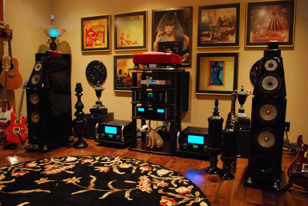

..I’ve got fhe Annie Mk IIs as well and have run the MC601s for 3 or 4 yrs now.  My preamp is the C500P.  IMO there is very good synergy between VSA and MAC...others have confirmed this.  Good luck in your search..

           I've been off line for a For a week or so but my answer to what amp I'm using to drive my VSA speakers is a McIntosh MC352.
            I also use this amp to bi amp the speakers. I'm a happy camper when I hear the music in my system. Like everybody who is an Audoholic
            we are all trying to improve the sound of our system. I hope this information helps.
