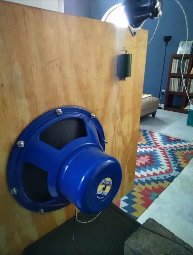

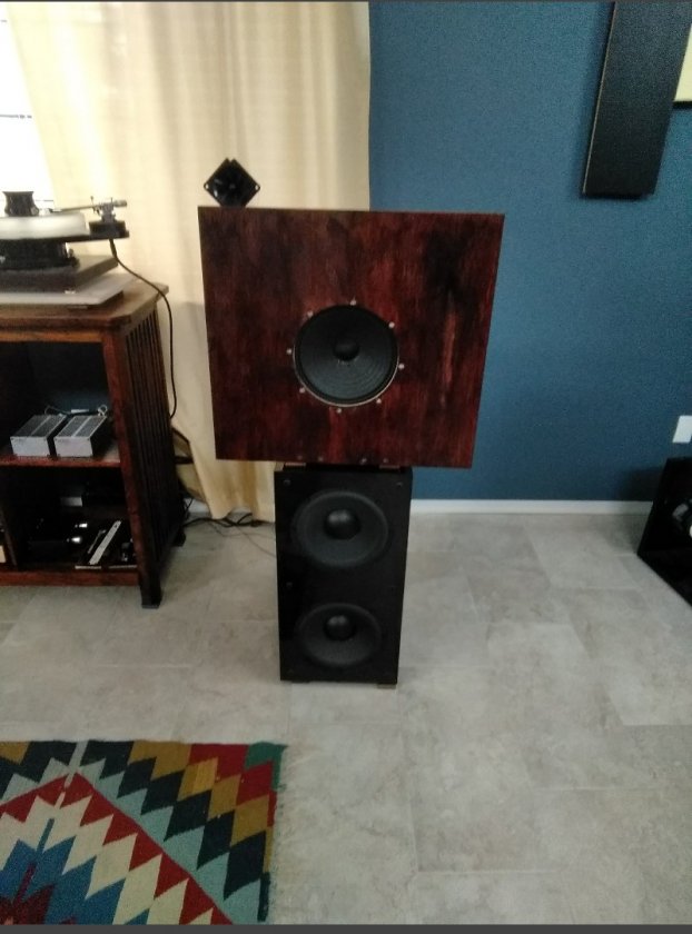

Speakers: Ted Weber 10" Blue Pup Alnico 30 watt run full range no dope to cone thus far. (2) NHT SUB2 subwoofers with 500 watt plate amps per unit for left and right channels. Tweeter's are CTS Piezos on a 1st Order crossover.

Capable of doing large symphonic, rock and and small chamber music with ease.. In fact when I throw on Richard Strauss's Also Sprach Zarathustra Op. 30 with Berlin and Karl Bohm I feel as though the speakers are mocking me " this is all you got,  :lol: come on, bring it on! " Just fine tuning amplifier tubes tweeter positions and various other things as these are far different than the Alpair 12P OB's. I'll post more pictures shortly as this platform kept flipping my pictures from my tablet.

Here's some more pictures.

I had a pair of those in a Vox AC15.  Punchy and articulate with a smooth, creamy breakup when fed a distorted signal.
Nothin' wrong with using guitar speakers like this if fed a clean signal.  They will steeply attenuate at about 4.5 kHz, so a well integrated tweeter will be mandated.  I think running them full range would be the ticket, paired with appropriately spec'd piezo tweeters you would not need a crossover.
A very cool set-up, but my wife would be contacting her attorney if I tried this at home!

And yes definitely not in league for waf :nono:!  After my divorce year's ago I had a pair of Altec A7 Magnificent speakers in a small living room, talk about audio insanity :icon_lol:.
Also, yes Piezos seem to integrate nicely with a 1st order crossover, that's all, Weber's running full range and so far everything seems to be running smoothly.

What do you intend to do with your tweeters. I see you have lined up the acoustic centres, but they are a long way from the mid rangers. You may find this thread interesting.
https://www.facebook.com/groups/133540410120537/permalink/1104476809693554/

Bumpy

I too like to listen to every change and one beauty of OBs is that I have found them to be not that critical to driver positioning.
That reference is good at suggesting starting points. At present I favour the rear mounted upward facing tweeter as favoured by the iconic Wharfedale SFB speakers, but I haven't tried it yet. :)

Agreed, rear upward firing tweeter has worked in my experience. In fact I used it for years on my last OB project with the Alpair 12P. This time things are different as room is much larger as well as baffles in our new home. I tried them firing up at first so now just trying them in other places to see what I prefer. :popcorn:
