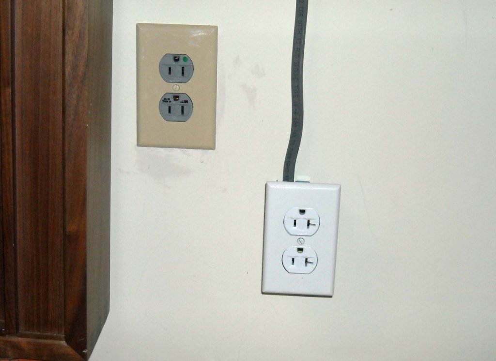

I ran over to Lowes and spent a hundred bucks for what I required.  I had to buy a hundred feet of number 12 Romex (20 Amp) as I needed just over sixty feet, by rough measurement, and it is sold as either 50- or 100-foot rolls ($60).  I did not want a splice in the line so it had to be a hundred feet.  I bought underground Romex as it was, for some reason, $30 cheaper than the in-wall stuff.  I got a new 20 Amp breaker ($25), the best 20 Amp Industrial Grade duplex outlet Lowe’s sells, $7, and a plastic old-work box ($1).  I had a Romex connector and plenty of duplex covers among my miscellaneous hardware.

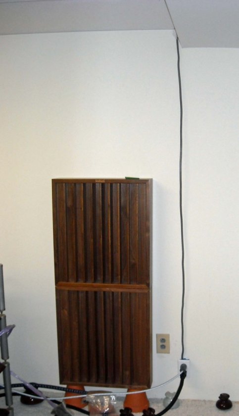

Running the wire through the dropped ceiling was straightforward.  In the utility room, I used cable ties to hold the wire to the cold-water pipes.  Overall, the installation looks pretty clean except for the wire running down the front wall of the listening room.  I think I can paint it and make it less obvious.
Clearly, this installation is not to code although it is safe to use.  If the time comes to sell this house, this line will be easy to uninstall.
I unplugged my stereo system before beginning work.
Putting in the breaker went fine. There is a subpanel and it has the extra openings that made adding this line possible.  I had to install the breaker using a flashlight but once it was in, and turned off, I could turn the lights back on in the basement, which made installing the outlet a lot easier.  The listening room outlets are controlled by one side of a dual 20 Amp breaker in the same subpanel.  The stereo is plugged into the fourth outlet on the circuit.
As near as I can tell, the wall outlets in my listening room are the only devices on the existing 20 Amp service so it is already a mostly-dedicated circuit.  The only thing that is on with the stereo when I listen is a lamp with an LED bulb in it.  It is plugged into the first of the room outlets.  I cannot detect any noise through my system attributable to the existing AC line.

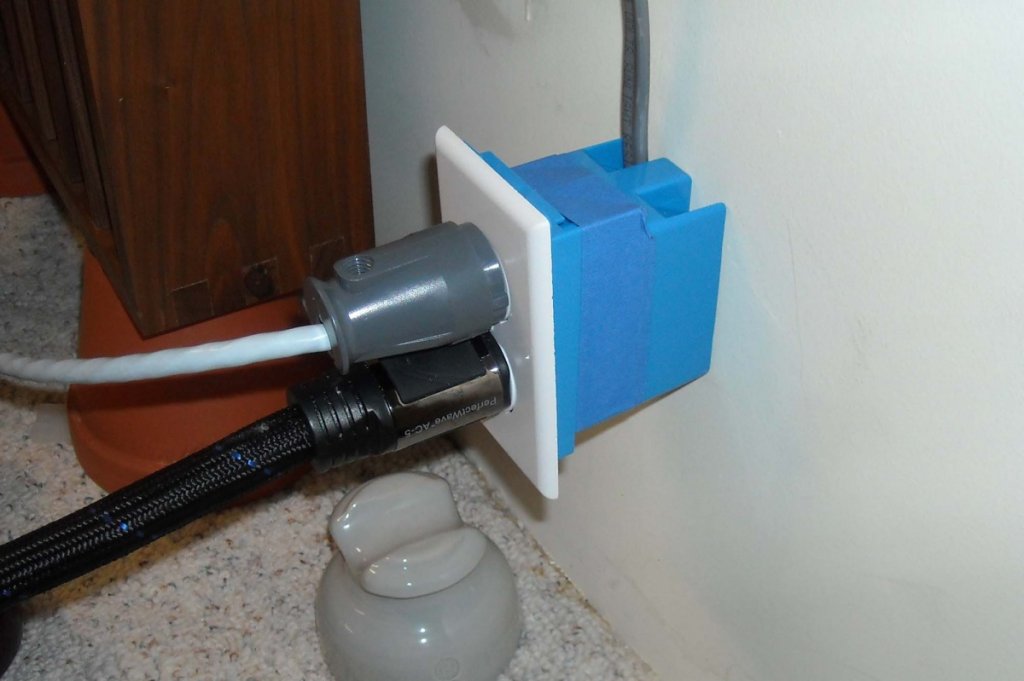

At the listening room end, I drilled a couple of holes in the back of the old-work box so that I could attach it to the drywall with hollow wall anchors.  I put a few layers of blue tape over the tabs that normally anchor the box in the wall simply to keep them from dangling.  The box is reasonably secure but needs to be held in place when removing an AC cord.  I positioned it a bit lower and to the right of the existing wall outlet so that the mounting screws wouldn’t hit the Romex in the wall (!) and that my AC cords could still reach it.

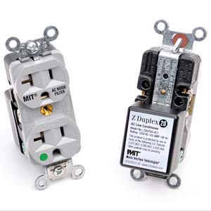

All the components in my system plug into a PS Audio P5 regenerator.  It plugs into an MIT Z Duplex outlet in the wall.   The MIT outlet is a 15 Amp hospital grade and includes a mains filter assembly that attaches to its screw terminals.  I won this outlet in a raffle at Rocky Mountain Audio Fest some years ago.  At the time it cost $100.  Today it costs $150.  While the filter assembly is intended to offer some line noise reduction, its method of attachment to the outlet is kind of a pain.  It is designed to be held in place by one screw on each side of the outlet.  This works fine when the mains wiring terminates at the outlet.  But if the mains travels into and out of the outlet, getting the filter tightened so it fits properly is difficult.  The depth it adds to the outlet is also a problem.  Currently, I am using the outlet without the filter assembly because of these issues and because, frankly, it seems unnecessary given what the P5 does. (The photo is of the 20 Amp version, which is $200, but the 15 Amp looks exactly the same.)
Before powering the system back up, I tried the P5’s power cord in both the MIT and Industrial outlets.  Subjectively, the grip on its prongs was pretty much identical with both of them.  I think one of the positives of most audiophile outlets (maybe the positive) is that they do grip the prongs of the AC plug more securely and this does relate to better sound.  This gripping ability is the difference between hospital grade and ordinary outlets.
