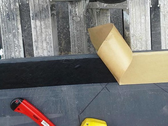

I bought this SP-15 a few years ago, it came with a ATP-12 tone arm.
Its from a broadcast booth from Alaska, and its in perfect, not a mark condition.
Built a 2pc, 5 layers of 1" pool table slate plinthe, surrounded with red stained Padauk.
I estimate about 250 lbs all in......why its 2 pcs.
Gonna need to build a table to set it on.
Im working on a linear tracking arm for it....why there is so much room on the arm board side.
For now I have a Denon 103R on the ATP, they play VERY well with each other, much better
than I ever dreamed.
Thats a heavily modded Jolida JD-9 between the plinthe and base.
Enjoy the crappy cell phone pics.....

PDR. Do you have sorbethane or anything between the layers of slate.?
And, good choice of music.
Graham
Hey Graham,
Yes, I used strips of self adhesive sill gasket approx 2mm thick between each layer.

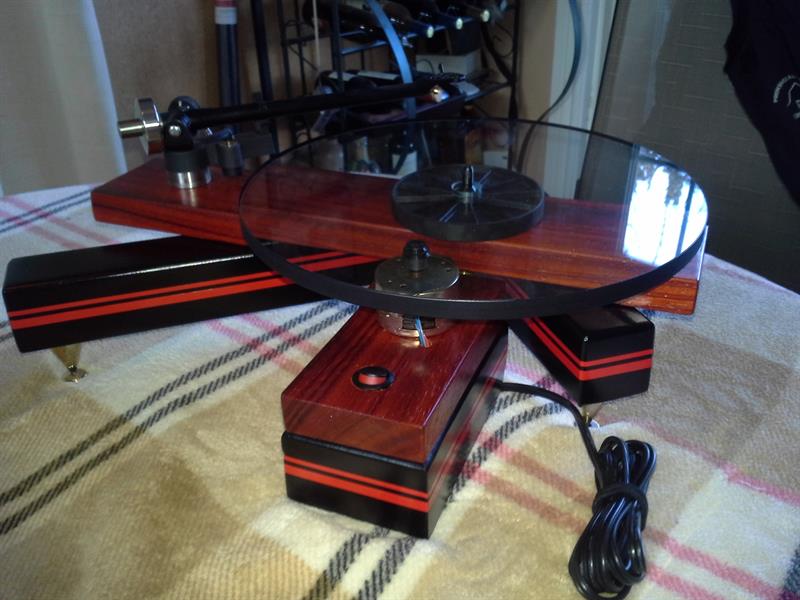

That is a beautiful table. I wish I had the talent to do something like this.
Thanks.....I like making stuff.
Heres a Rega P3......actually parts....that I put together with some of the
left over slate and Padauk wood.  "L" shaped slate with pin stripe.
