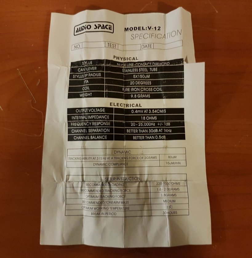

Experimenting with a used cartridge, an Audio Space V-12 moving coil cartridge with about 300 hours on it. specs posted in pic.
Everything is setup up properly however I am struggling to get enough gain. The tube preamp has a gain knob and its maxed with volume knob also maxed. With all this Im still only getting minimum volume and no low end. The phono stage has 60db of gain which I was told here is average. I was hoping the tube preamp would be enough to push it.
Perhaps other problems, cartridge loading issue? Amplifier pairing issue? Tonearm mass? Higher gain tubes? Hoping to learn as I go here.
Thanks for any help!

Something is wrong.  Cart output at .40mV into 60db of gain should be fine.
I use two MC carts with outputs in the .25mV range.  I run them into 3 different phono stages, each with 60db of gain.  Sound with all combinations is robust, dynamic and full, never use line stage volume control more than half open.
Sounds like your rig's overall gain / sensitivity profile is too low.  This can be caused by:
Insensitive speakers,
and/or
amp with low input sensitivity,
and/or
a low gain line stage
If not any of these, then something is broken.
Your line stage has has a rear control knob for amp matching.  I'm guessing this adjusts your line stage gain.  Have you tried using it?  My preamp has the same adjustment and I find it very useful.
