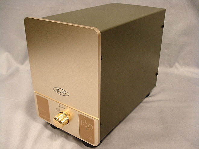

Thanks for the great responses. I don't think I would ever go over a 2:1 cart to TT price ratio from the general knowledge I'm seeing here. Which should be just fine. I've got a Pioneer PLX-1000 and was browsing some used carts online in the 1000-1500 range new and going for much much less. Thought I might experiment possibly. I'm thinking my phono stage will be ok also, Tokyo Sound PE 100 SE.
