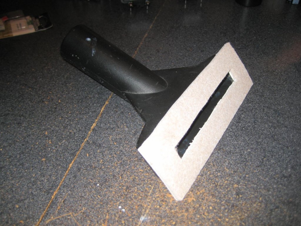

I'd love to have an RCM but this attached to my shop vac is working great.
It will actually pick the LP up and hold it in mid air.
Here's my cheap $0.50 DIY vacuum nozzle  :D.

That should do a pretty decent job.  :thumb:  I'd get two cheap chip paint brushes for fifty cents, cut the bristles back to 3/4", and whatever cleaning solution you prefer.  Use one brush to clean with solution, wipe with a cloth, use one brush with distilled water, and then vacuum.  It gets most the crude out into a towel, and the cover on the shop vac will stay clean much longer.

The nozzle I made is really working out great and does not scratch the LP's.
McMaster-Carr sells some very soft felt with adhesive backing.

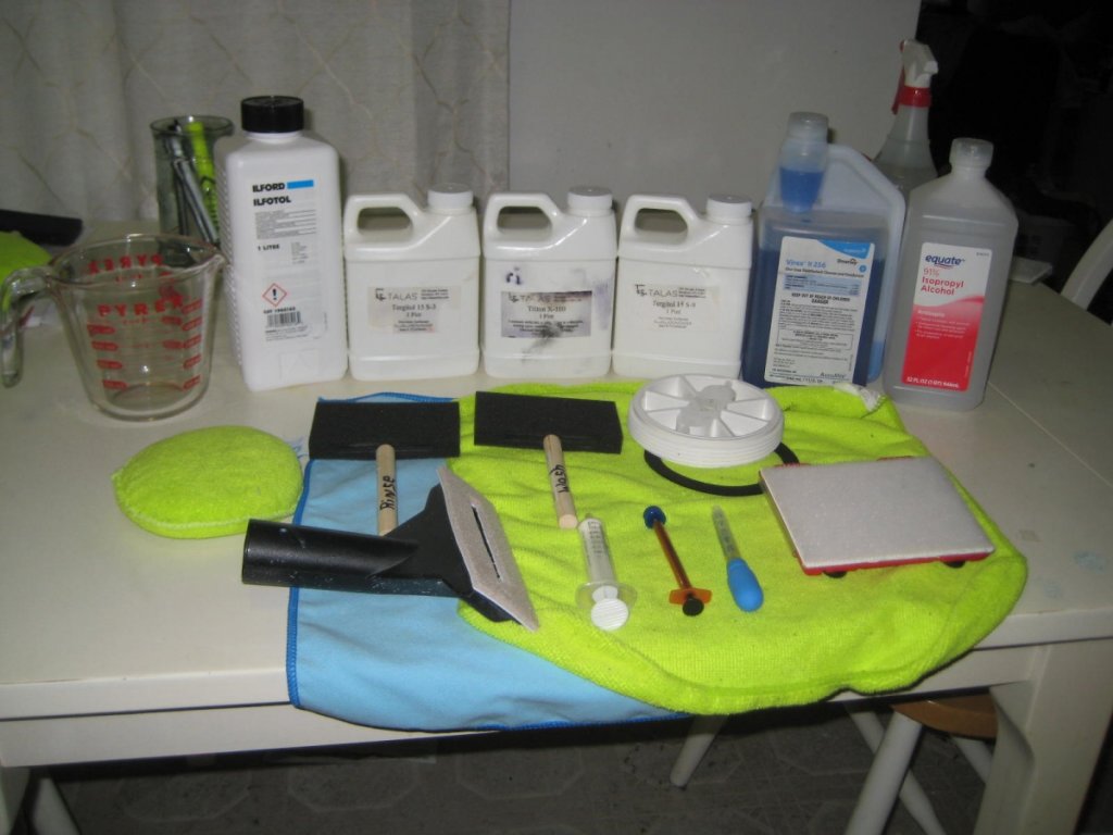

Here's some of the products/Items I've experimented with over the last year.
I can't tell you how much I've learned in the last year.
Tergitol 15-S-9, Tergitol 15-S-3, Triton-X100, ILford ILfotol, Virex256 for anti-static property, Distilled water, 91-99% IPA, misc oral syringes, paint pads, ect.
A lot of trial and error with mixers over the past year but I've finally found a favorite recipe for my manual cleaning regimen.
