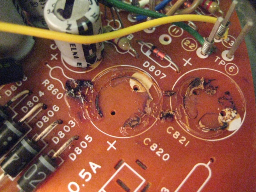

I'd also like to get a new arm for my TT-71 (JVC QL-7). It currently has a JVC/Victor ua-5045.
BTW, I'm currently replacing all the Electrolytic Caps in mine due to leakage.
You might want to have a look at yours when it comes in.

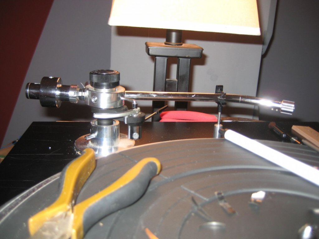

Here's a picture of mine.

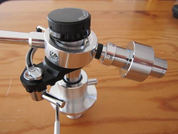

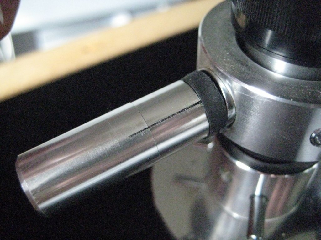

I have the upgrade bug but no funds at this time for a new arm.
Known problems with the Victor UA-5045/7045 arms are the sagging counter weight assembly.
I fixed mine but haven't tried it yet since I'm changing out the caps.
Also, one of the tiny set screws in the round collar broke because it was so tight, maybe with loc-tite. Not a big deal really, just aggravates me that I broke it.

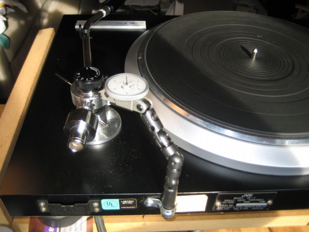

It does have good followings and have adjustable VTA.
Other arms you may want to look at are the Fidelity Research arms, FR-54 is one of them.
Here's a couple before and after pics.
How do you like my dial indicator setup to help me adjust VTA, pretty cool you think  :D

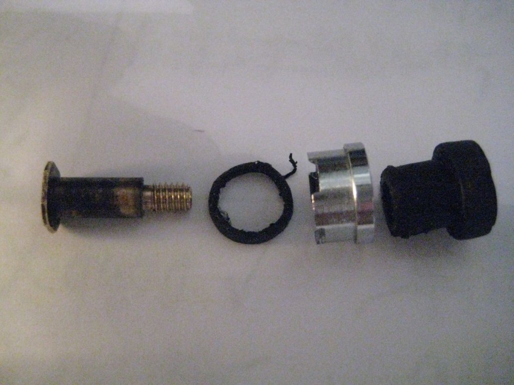

A few more photos of the UA-5045.
Deteriorate rubber causing sag, that little tiny steel collar is only 3/16" long and has to hold up the entire counter weigh assembly (more sag),
plus it's 0.012 smaller in diameter then the hole in the arm, (even more sag), should be a slight press fit into the arm IMO.
If you can get one for $100.00 in good condition I'd go for it.
