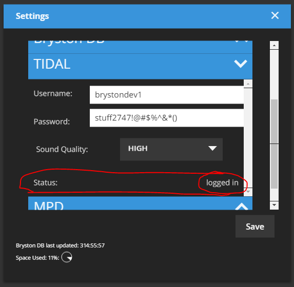

If you go into media player settings (gear), under TIDAL, what does it show the status as?

Yes, is says logged in.
D
the quality set to lossless? Can you give me the names of a few tracks you tried playing that experienced this problem?  Could you run and report the results of the below speedtest please?  It also could be helpful if you placed the bdp into service mode and emailed me the service id.
