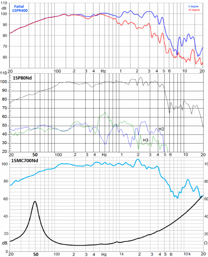

12 and 15'' FR have a impressive mid and midbass presence along with great transient capability and in a big BR box the bass is superb, better bass (under 200Hz) is only avaliable with a 15'' woofer as DeltaLite 2515 or Faital 1515PR400 or Beyma 15P80ND in a big BR box.

Best box for big bass is a large BR box (over 100L) that will built a deep bass, in this case it fit well with big drivers from Commom Sense 10/12/15 FRs.
OB is a great opportunity to use a 15'' woofer as Delta Lite 2515, Faital 15PR400 or Beyma 15P80ND in a big BR box with a 6/8'' FR in OB over 270Hz, the boxed woofer will delivery fast 99dB sensitivity not 94dB as in OB.
I favor the Beyma 15P80ND woofer why it is easily avaliable here.

Faital and two Beyma, all Neo magnets.
