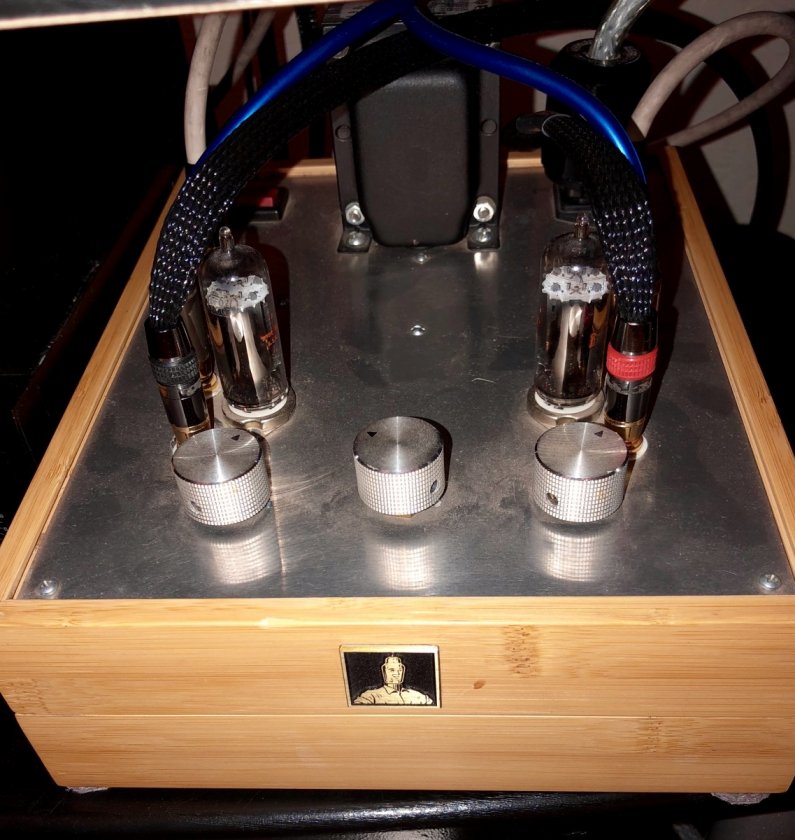

Today I put my Bottlehead Foreplay II back into the system.  It is a highly modified foreplay with shunts, Mundorf
Caps, beefier transformer and set up for 6FQ7 tubes.  It is dead silent and is otherwise a simple passive unit but sounds huge.  The air with it is much better as it feels much thicker and full, yet very detailed.  This is the same pre that replaced my 1961 McIntosh MX-110 several years back.  The MX-110 was completely restored and aligned. It sounded wonderful.

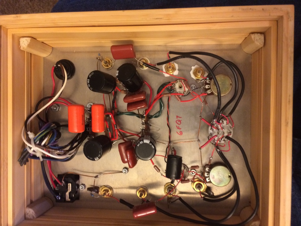

Excuse the dust😟

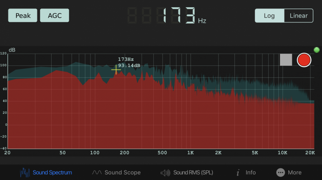

The obvious answer as to why more slam is that the Yamaha amp has more raw power that allows me to use more of the panels for mid bass and rely less on subwoofers to get proper levels from 60hz and lower. The panels without subs on the Yamaha go down to 40 before falling off.  With the AR VS110, down to 50’ish which is a big amount that was going to the subs.

Screen shot

Hi Michael:
Shunts basically are resistors in passive circuits, in this instance a high quality resistor on the sweep ground lugs of the potentiometers.  Instead of the “pot” carrying the signal, the shunt does which is a shorter and cleaner path.  The results are day and night.  There is also a power supply shunt regulator to keep the current current constant.  Both really keep the pre silent.
Jim
P.S.
Here’s what’s been modded from the original layout:
It has Pseudo dual mono power stage (PDMPS), each signal wire is shielded and has its own ground, done like they did on the Foreplay III , the volume controls are in shunt mode, it has  RRSF which is a filter to take any nasties out of the electricity coming from the wall. It uses Vishay-Dale resistors, which I think sound very good. And finally it has an IEC connector and am using a home brew power cord.
