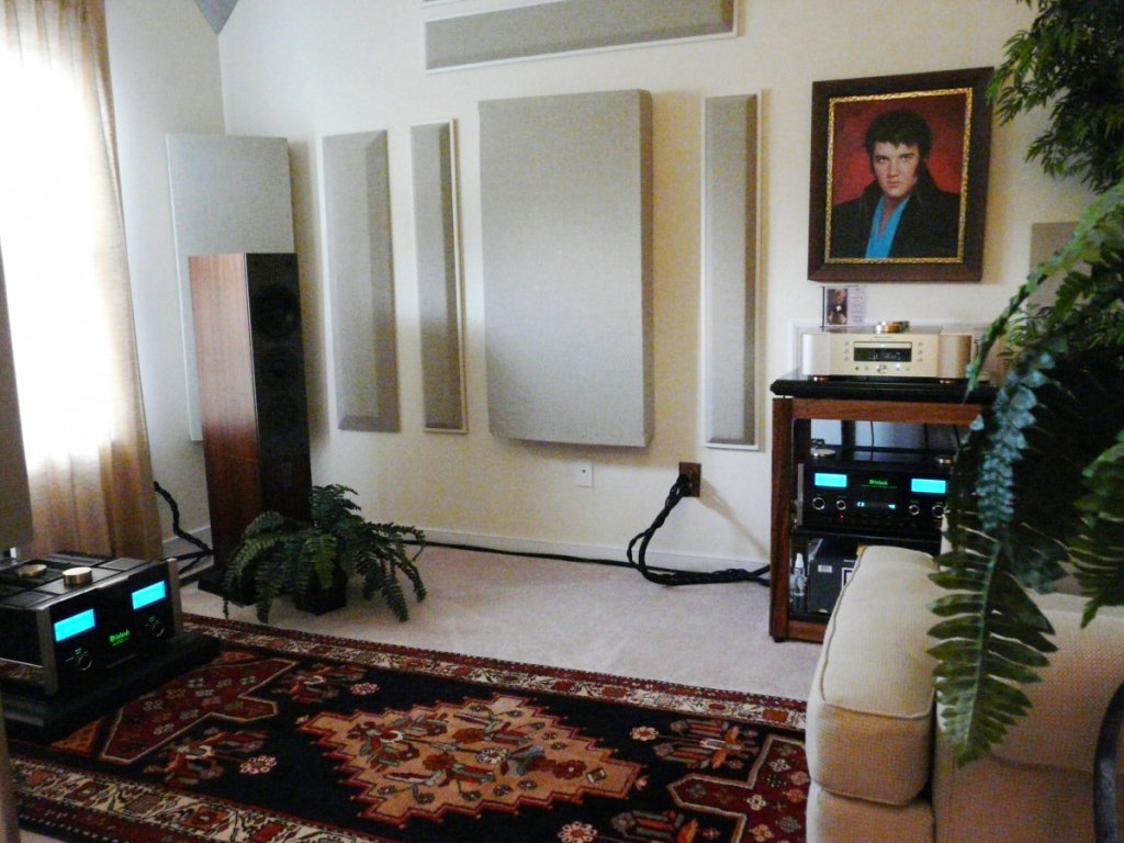

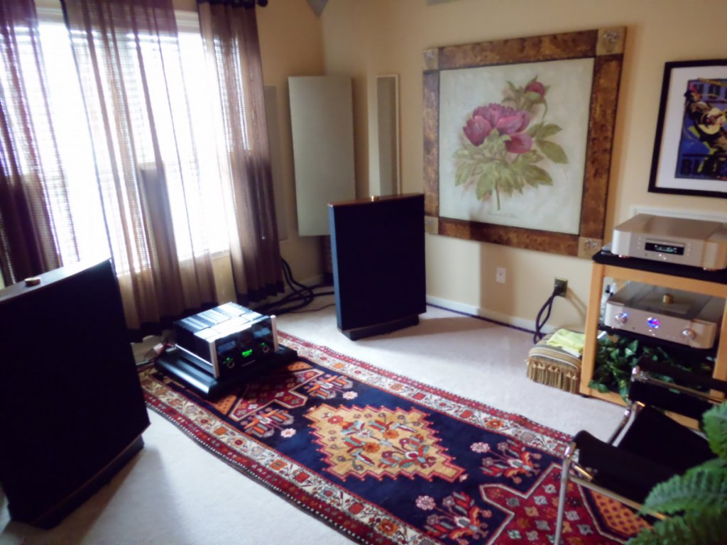

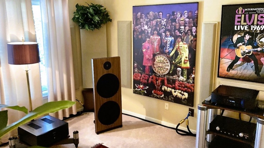

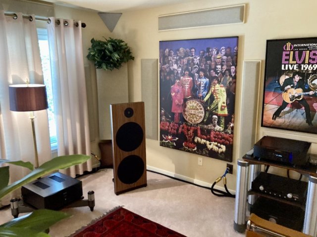

Curtains can work as long as they have some thickness and weight. Also blinds when titled up a bit makes for good defusion, so together they work pretty well. Bass traps are still helpful as well as side wall treatments of some sort. I wanted a decent room but also one that looked good and not like a studio.
He a few pictures of the same room with 3 different systems as I treated them.
The current one is the Spatial open baffle speakers, even when I added the lamp with the large shade added so tighter middle imaging.
